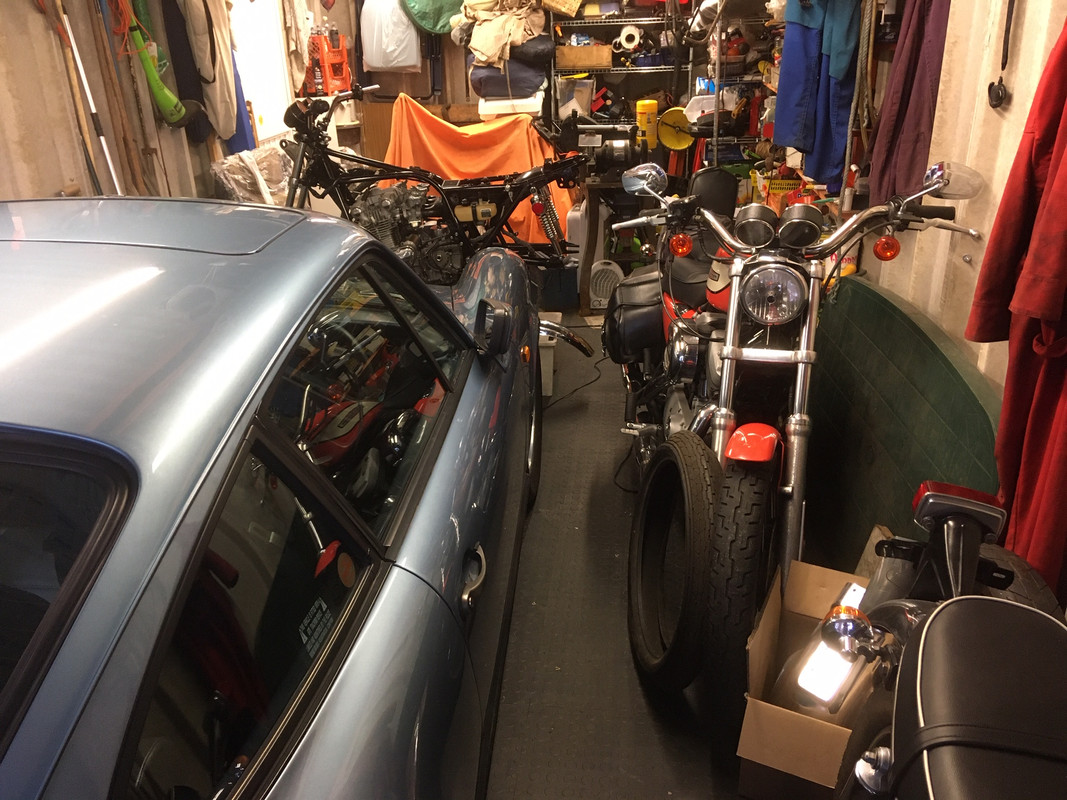

All looking very nice, Roy. I assume that the seat from Vietnam is the same firm that did my CL450 seat, a good likeness and fit, and they must be out of reach of Honda's lawyers, as they're not shy about using the lettering on the back of my seat. My only criticism was that Vietnamese imitation alligators must moisturise,  because genuine seats I have seen have a much coarser grain.
Speaking of crowded garages, here's mine, now the 911 has returned home.
I'm deliberately leaving the Z1A's back wheel and mudguard till last, because once fitted you won't be able to get past  any more. However being mobile will mean its a lot easier to try and fit the bike at an angle than it is now on the crate.

Your garage is as bad as mine! The trouble with a garage is we tend to fill every spare inch of space with motorcycles  ::). I've bought a s/h roland drum kit to relive my mispent 'yoof' and that's in there now next to the Myford! I think the o/h is slowly moving me out of the house ;D
