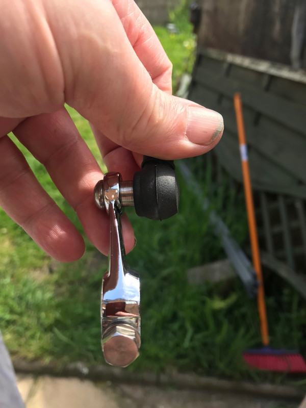

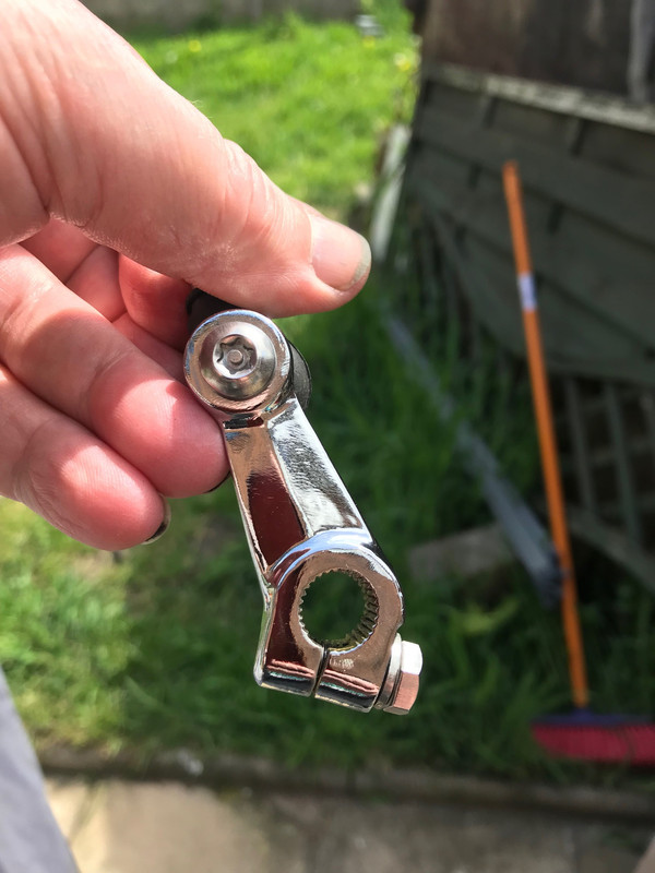

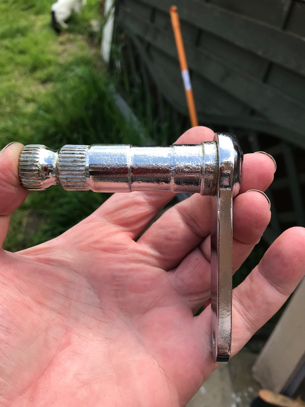

CB400 gear change linkage, first part of the mod done. Need to do some more work on the lever but the linkage bar is done and ready to go get chromed. Chromed, new rose joint fitted in stainless steel and anti-tamper torx bolts, new pinch bolt in stainless with a nice thick washer to stop the bolt head digging into the new chrome.

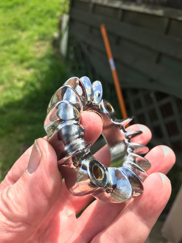

Exhaust clamp, CB500. Started off like this. Chrome seems to be right down the fins where it normally doesn't get due to polishing restrictions.

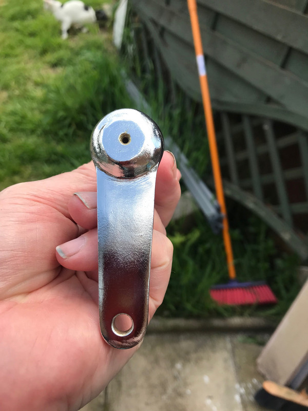

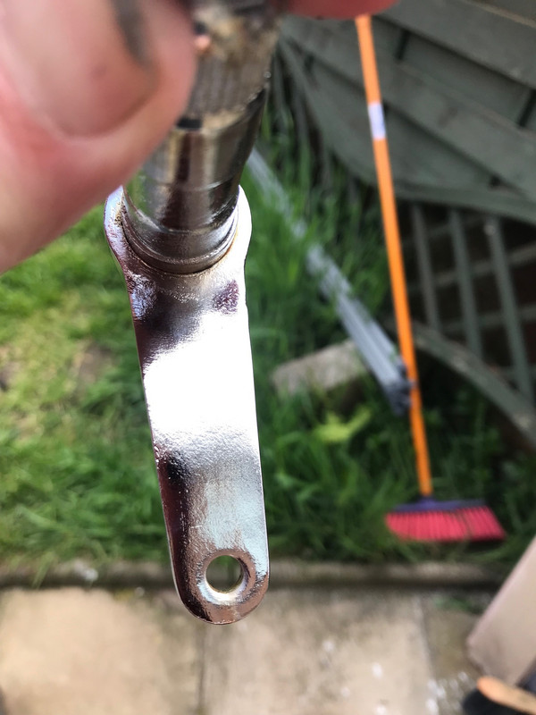

Finally, rear brake lever linkage joint, the part going through the frame was very rusty and corroded. The rest wasn't much better TBH, took some work to get a decent result. May use this, may not.
