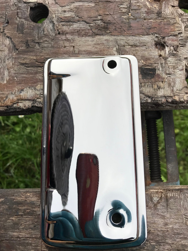

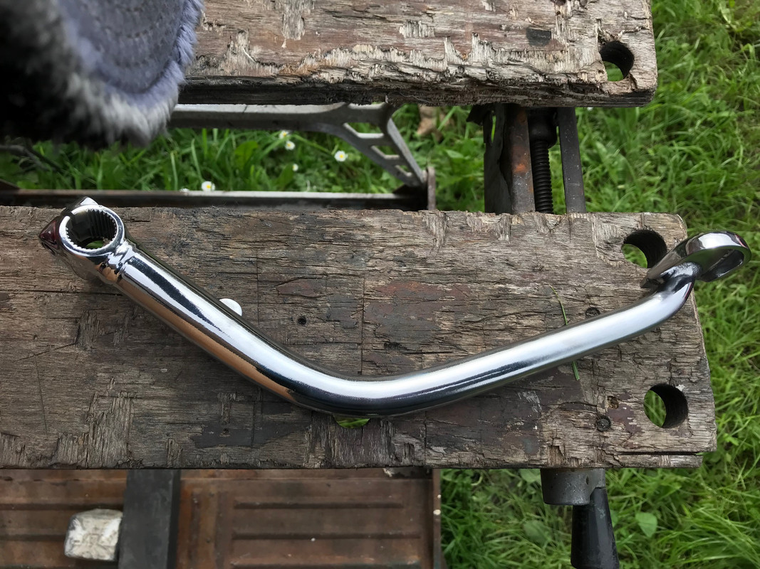

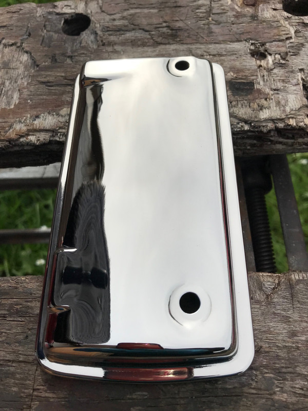

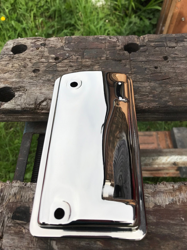

Just thought I'd post these here so you can see what you passed up on  ;D ;D
The starter motor cover that was gold, stripped off the gold which TBH was actually very easy, just used a Dremel and a light sanding wheel, turned out really nice under the gold, not a lot of pitting and what was there was quite shallow. So after a bit of sanding etc I finally got round to polishing it ready for the chromers, the brake arm is ready at the chromers BTW, picking it up on Monday when I drop the next lot off. Due to the amount of prep work I'm doing on my parts he's being really generous on the cost of chroming them, which is good as it keeps the overall outlay down.
Starter motor cover, just polished, not chromed, YET.
Gear lever, just polished.
And just to show you what you can achieve with old parts, a CB550F2 front indicator stem, stripped of chrome but heavily pitted, mostly the front side which faces forward.
And after sanding/grinding all the pits out and a little polish. You may not believe this but I actually wasn't that pleased with the result as there were still a couple of pits left so I redid it yesterday to remove them. I have 3 of those plus 1 NOS stem.
And a CB500 rear brake lever, chrome stripped, sanded, ground and polished. It was finished but again I spotted some small blemishes so I started to redo it, hence why there is some sanding marks on the front of the pedal, it's now done.
So don't give up on parts which you think are maybe scrap, you can save a LOT more than you realise and considering how expensive these parts are too replace and that's assuming you can replace them, it's cheaper in the long run to try and save them, your labour is essentially free so why not use it and save a LOT of money.

I am in awe of your polishing skill Ken, what do you use to get the pits out of the steel items without leaving scratches in the metal?
Love the 500 and 550 have a 500 called Lazarus under restoration

I use a small grinding stone in a Dremel, genuine Dremel stone only as the copies tend to be crap. Something like a Dremel 952 or 8153, aluminium Oxide stones. I have a selection and it depends on access etc as to which I select. That's usually to get deep pits out. If the part is circular, like the stems, it can have a tendency to threepenny bit them so unless the pits are really bad I'd use a 80 grit flap wheel in a Dremel, like a 502 or 504, these I do use copies for but find them much rougher than genuine Dremel but miles cheaper. Just bought 20 of them made by Winfred which are not bad. So I either sand or grind until pits are gone, this leaves the surface pretty rough TBH, so I then resort to either a 36 grade Speedclic abrasive wheel to smooth it down somewhat or my new choice is to use some new ones I found recently which are MILES cheaper, I was very sceptical of them when I first bought some but they are really good. I may sell some on the forum in a selection of sanding grades, there are 7 in a set of various grades, TBH for metal only the bottom 3 really work but the next 2 grades are useful on alloy for instance. So I sand down using 36 or 80 grade abrasive wheels and then finish off with a 220 grade wheel. Then onto the polisher, you can see reflections of one of the mops in some of the pics, I start off with a felt wheel with grey soap to get the initial shine and finish off with a cross stitched cloth mop and white soap, I have others and use them on some but that's it's in a nutshell.
The stems weren't that hard TBH, took me about 1 hour to do each one sanding wise and another 30 mins on the polishing machine, this should give a surface smooth enough for chroming to really shine on and have no underlying marks which chroming just doesn't cover. The other side of this is that the chromer loves getting my parts, less work for him, quicker turn round, normally less than 2 weeks to get them back, sometimes less than a week. TBH the chromer I'm using isn't considered to be great by others but I think it's a case of how much work they are prepared to put in to get it right, if a lot, like Prestige then that's reflected in the turnround time (around 6 months at Prestige) and the price. The brake arm ( the one on the brake plate) was done for around £10 for instance, he charged me £15 to strip a pair of handlebars and chrome that brake arm, so £5 for the handlebars and £10 for the arm is my breakdown.
It's not hard, it's just incredibly boring, however in winter it's something to do so why not.

No they come out even brighter TBH, the better the underlying surface is the better the nickel plating above it, chrome is clear and it's the nickel that gives it the shine.
Just bought a job lot of parts which include quite a few shiny bits, along with masses of engine parts including 6 camchain tensioners, I'll be restoring most of those and selling them on to make a bit of profit. There are at least 4 starter motor covers I can see. All look salvageable, there also appears to be a 750 points cover but what condition it's in is not clear, might clean up though and be worth a few bob nowadays. £250 for a new one now, ridiculous price.
