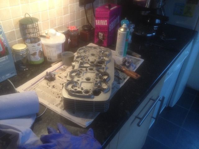

Here's what was going on in the kitchen yesterday, while the wife was away, more gasket scraping going on here. The teaspoon made a good scraper for the carbon in the combustion chambers, after I softened it with the gasket remover. ;) Later I put the valves and springs back, after lapping them in. Ive still got to have a go at getting the oil jets out, or Trigger will tell me off, but then the head can go back on once they are cleaned out.
