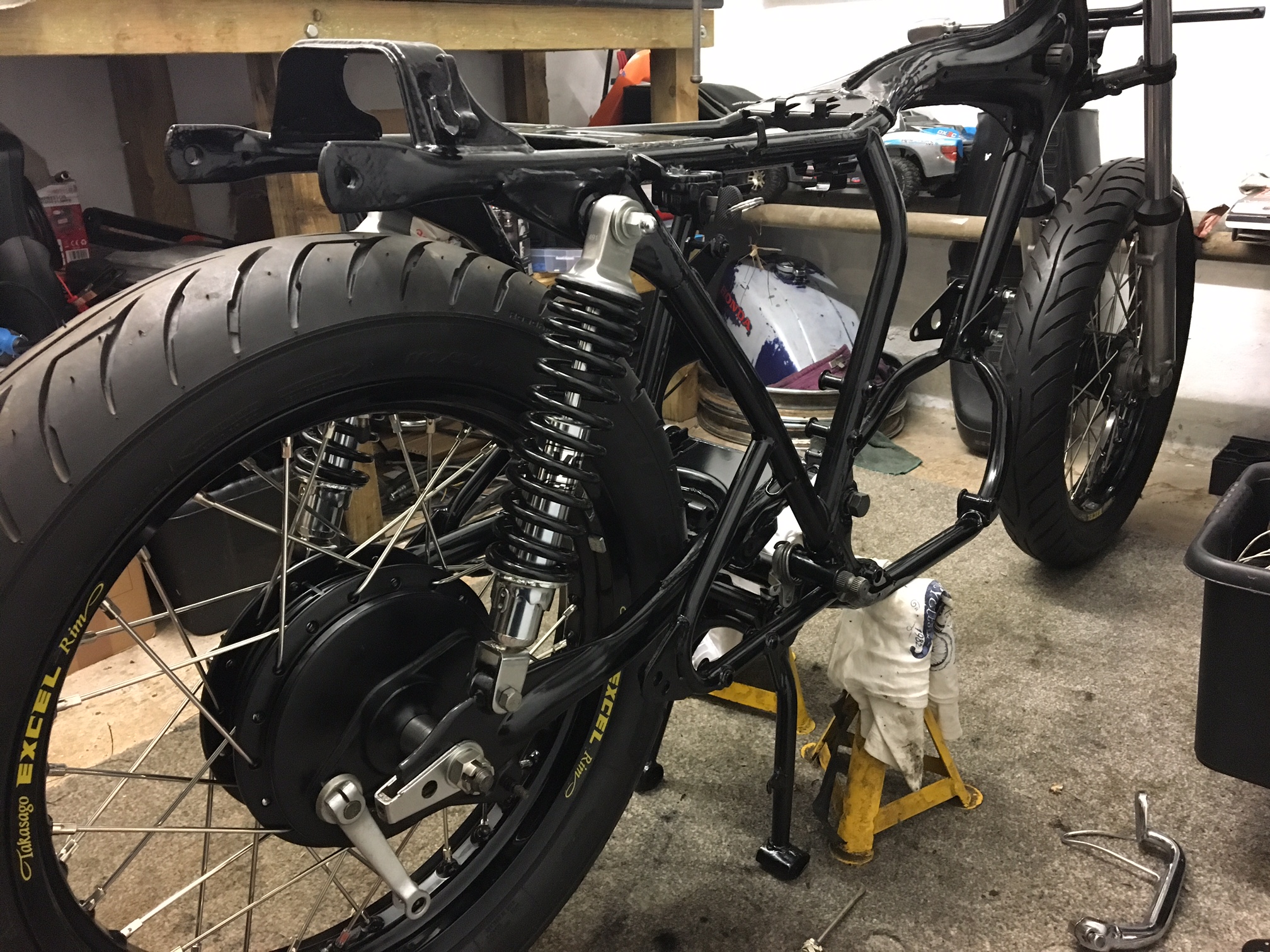

Heres a pic of it not connected up at all..

It locates on the frame down tube and the small arm on the splined brake pivot.
can't get a picture while later but hope the attached helps.
Offline Integra99
  • Posts: 207
Re: Rear Brake Return Spring - CB400f
« Reply #3 on: October 04, 2017, 03:58:36 PM »
Thanks Paul, yes I keep looking at the same diagram.. and I have the location on the down tube in the hole. Looking at the diagram should the spring locate on the left side (against the small arm for brake switch) or to the right side for the thicker arm that locates the brake are/rod)
I hope that makes sense.. I'm going to feel silly when I work it out , but with the swingarm on its very tight so I may need to drop the swingarm back out.
« Reply #4 on: October 04, 2017, 04:24:54 PM »
No hole in the frame the loop on the spring wraps around the tube !!

Ah ha in that case my spring has snapped!! David Silvers again.. lol!! Thanks Paul .

Place a bit of heat shrink on the long tail of the spring otherwise it will mark the paint on the frame. Honda used a piece of very tight fitting, thick walled rubber type material. I had to use a heat gun to make it go pliable to remove it before getting the spring re-zinc plated.
