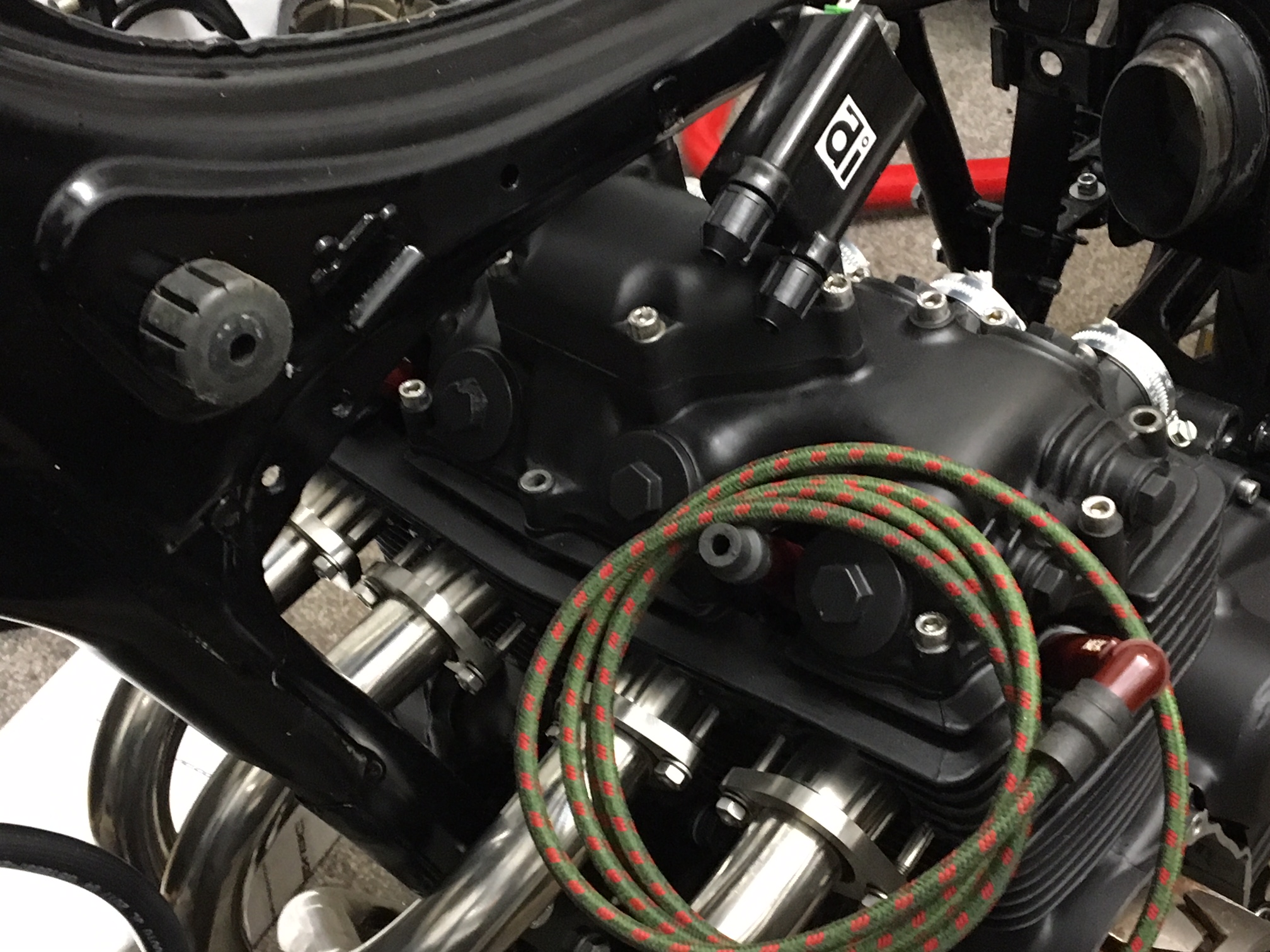

Its been a roller coaster doing this CB400.. and at times I've got dis-heartened.. with costs, constant problems and hard work.. and only the other day I thought about walking away for a bit but I've finally finished my CB400/4 Carbs, I decided not to get the casings vapor blasted as I liked the matt look apart from that they are literally brand new with every part changed or zinc plated, so its given me a boost!
I was trying to find a pic of them at the strip down and found this one.. also shows how bad the engine was.. let alone the wiring loom.! I'm very close to getting her all back together.
Before....
Engine....now

Coming on nicely is that.  How far off is it?

The chewed-up tappet cover looks familiar! I have had one (in about 1989) completely snap off- the hex casting, leaving me no option to chisel out the remaining mess and on my present 400/4- which considering I had it all apart 5 years ago- one wouldn't shift until I took a chisel to it- which took a chip out of it and I had to replace one...

Thanks all... its been quite a journey and I only stripped it to weld a rust patch on the frame.
Yes the tappet covers were really bad, well two of them, I think I may put them back to polished metal as I've sourced two new ones.
