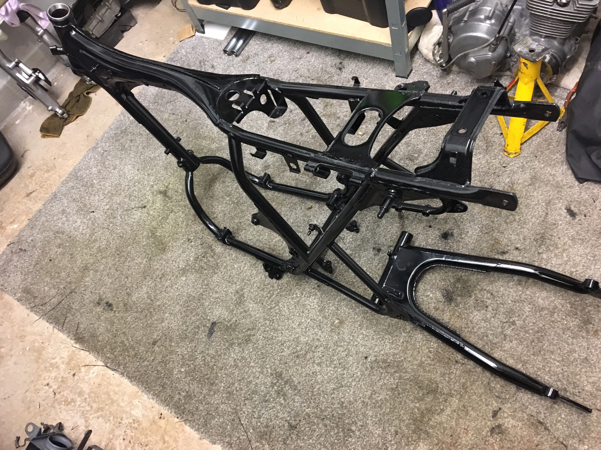

Here is some original Honda frame paint for comparison......very glossy, very thin, shows up every tiny detail, still looks superb, all it required was some of the welds touching in, the paint on the frame tubes is all Honda.

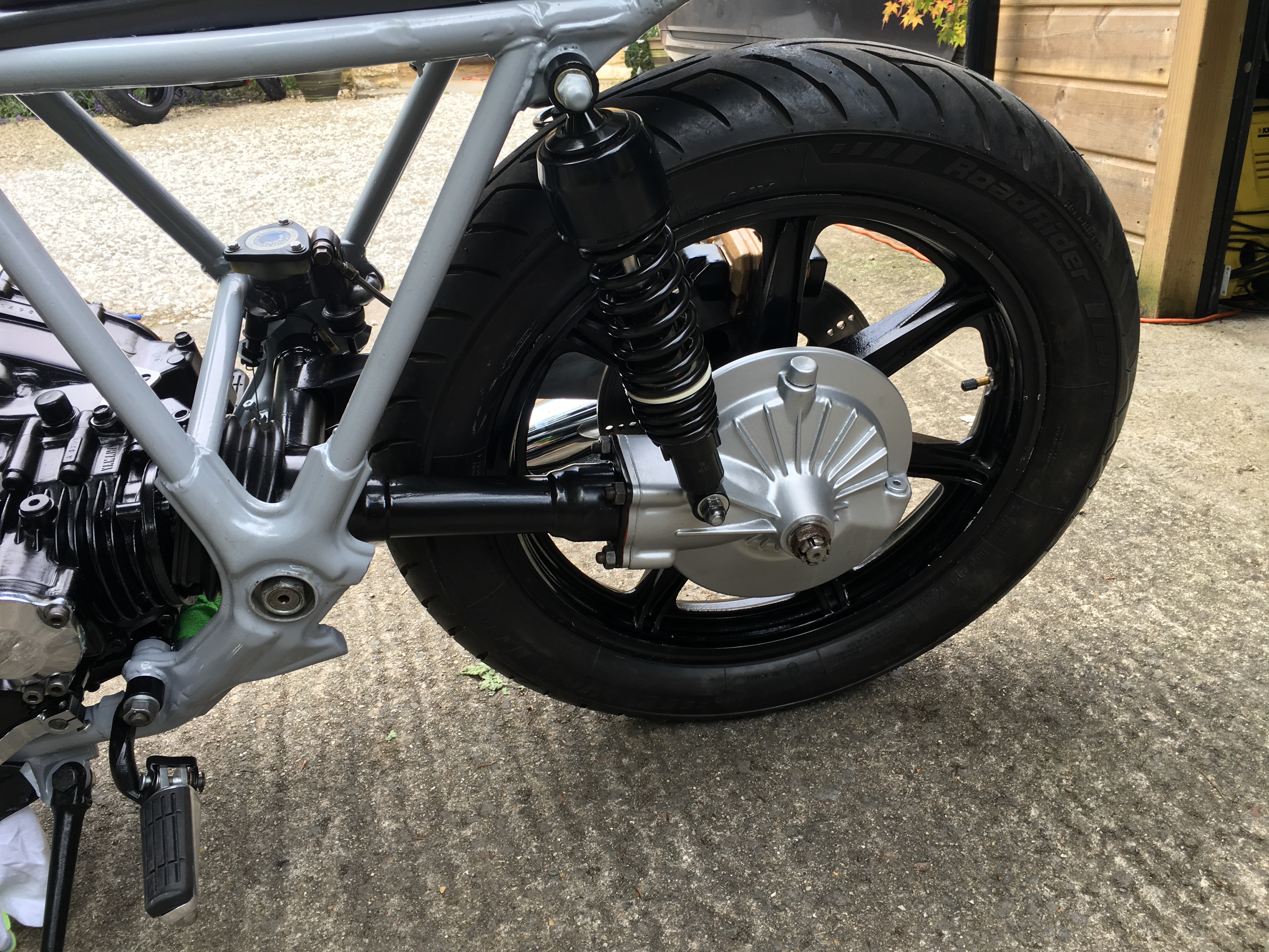

If you are going for an original restoration paint is best.. and you can touch it up much easier and looks more original I suppose. I had my CB400 painted and baked in a spray booth, came out lovely... and was quite inexpensive vs powder.
I've had several frames powercoated as well and wouldnt hesitate to powder coat another.. as the finish was superb and very durable far more than spray or rattle can.
Paint...
Powder..
Integra99
SOHC Member
Posts: 207
Re: What to do with frame
Reply #10 on:
February 27, 2018, 11:19:46 AM »
As you can see Powder is far thicker than the painted finish.. hence why I wanted the CB painted!
Golfcarmad
SOHC Associate
Posts: 84
Reply #11 on:
March 04, 2018, 11:01:54 AM »
Frame n s arm gone in for powder coating £90 in Birkenhead

Stripped frame myself , replaced swinging arm could not find a blemish!! Finish will be perfect or no monies will change Hands
