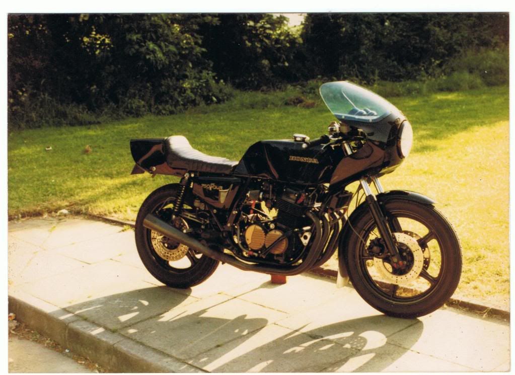

Only just had a chance to begin to read about this project. Got as far as the part where the basic part of the bike was carried through the house & it reminds me of the 3rd rebuild of my 750F2 back in the early '80s. At the time I had an upstairs maisonette so there were several flights of stairs to navigate so as to get the frame & engine assembly down to the garage.
This was in my bedroom...
Bikes...they're in the blood.

Have to ask though...that frame...doesn't look standard. Looks like you can actually work on the engine with it in the frame.....
CB750F2 - in pieces
Yoshi823
Posts: 911
Biker to the bone...
Re: CB750F2 .... silk purse from a sows ear.
Reply #174 on:
November 12, 2018, 09:57:17 PM »
The standard frame was modified so that the top end was able to be worked on, mainly because I had a tacho drive oil seal go & I ended up having to remove the engine just for that 20p (at the time) seal. As I didn't have any of my own facilities at the time, I had to use a friend's garage, much to his mum's annoyance.
The modified frame needed a new tank to be made, which wasn't a problem as I wanted a Phil Read Replica style tank
