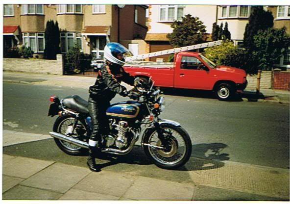

« Reply #28 on: November 12, 2018, 11:07:26 PM »
I used a standard 550F master cylinder with the double disc installation on my commuter 550. I had Ferodo Supersport pads in one caliper & Vesrah pads in the other. This gave me double disc braking in the dry & single disc braking in the wet, as the Vesrah pads in those days weren't sintered at all  & absolutely useless in the wet. I also installed Goodrich Aeroquip braided brakelines, as these were the only ones available back in those days. A double length banjo bolts held the double lines into place on the brake switch junction.
A few years later I swapped the double discs over to Mrs. Yoshi's 550F2
