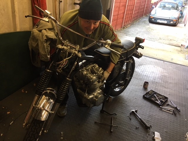

Here's what I use to get engines back in:
Big Leigh is 6' 7" and can get a Harley engine into the boot of my car. he's also very good at keeping our place in a taxi queue.
Re: 1967 CB450K0 Black Bomber Rebuild - By Royhall
« Reply #23 on: February 13, 2019, 07:35:02 PM »
A winged helmet and its OGRI!!!!!
