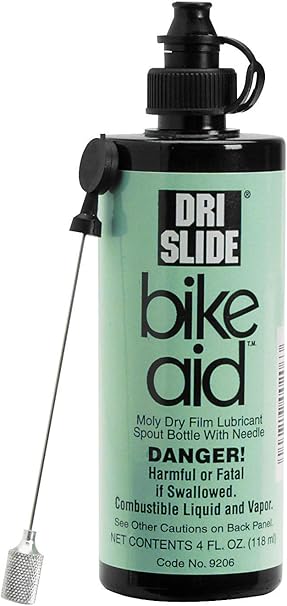

I've used a moly lubricant called Dri-Slide "Bike-Aid" on all my bicycle and motorcycle cables to date - it's a dry lubricant carried by a volatile liquid which evaporates.  A 4-ounce bottle includes a fine needle applicator which makes it easy to apply it to the full length of the cable - just gotta have gravity working in your favor!  I'll use it for this clutch cable - if it works, great!  If it doesn't, lesson learned and I'll seek out an authentic Honda cable...
https://cdn.shopify.com/s/files/1/0095/7332/files/TDS_Bike_Aid_1bf2271d-3f84-4a3d-9c95-eb0eea9f7183.pdf
