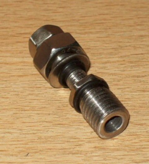

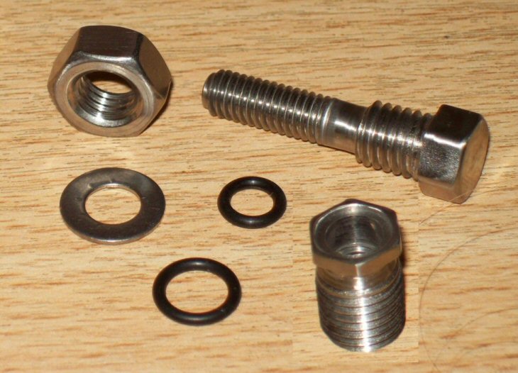

I have just used this kit.
Excellent service from Dennis at no and rattles and an excellent repair.
You need a 8.5mm drill bit and a 10x1.25 tap drilling deep enough for 13mm of thread - from the man himself.
He also does a replacement bolt, without the insert.
