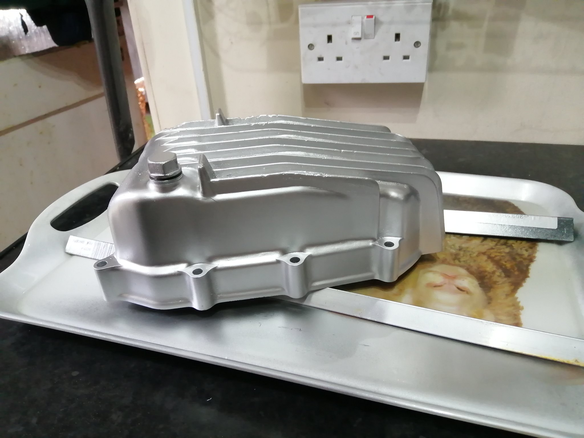

Can't leave it alone so yesterday finished oven baking the sump. Baffle plate was slightly rusty so it had the "Evaporust" treatment as I could not undo the holding screws it was done in place over 2 days. Decided against grinding out sump scuff - left its lightly battle scarred looks on the fins.
.sump with age scars by Teddy Bagshaw, on Flickr
.inside sump by Teddy Bagshaw, on Flickr
