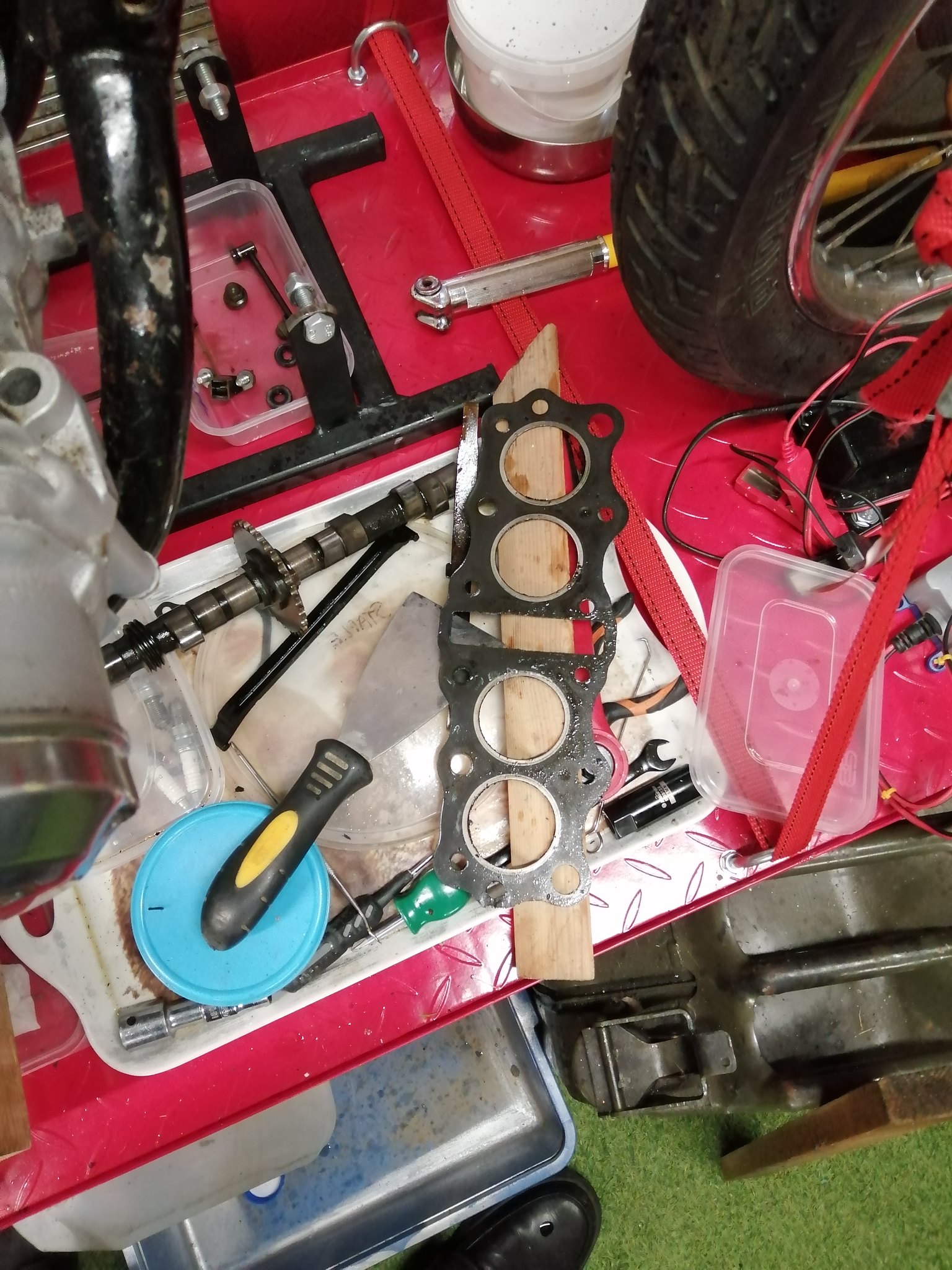

old head gasket
by
Macabe Thiele
, on Flickr
Thanks smoothoperator for the tip - I used a plastic wedge as used by double glazing fitters and gently tapped it int on outer corner. Fed plenty of WD40 into the gap - in a series of tapping the wedge with a rubber mallett and removing it then tapping the head all round it finally let go!
The cylinder head has been off before as there are small witness marks from a chisel or screw driver on both sides. So far looking good - the head gasket is a black material - no sign of blowing anywhere.
I suspect that the exhuast manifold head connections have been leaking with the blow by building up a carbon deposit causing an external bond between head & cylinders.

piston close up
by
Macabe Thiele
, on Flickr
All of the pistons look like this they have Honda brand on the skirts, some carbon between the first & second ring just a light brown coloration above the oil control ring. Bore remarkably wear / step free.

The whole thing doesn't look bad at all really. Looks like it's been well oiled from the components on view, even the cam looks as though it's been run with correct clearance for valves from that cursory picture of it.
Head gasket all seems to have been running with no leaks, indicating competent last intervention from whom so ever.
As you already recognize, it's been running "generously" jetted with that colour and carbon. For some time too, as you can see the "correct" colour of exhaust valves as undercoat !! with a fair thickness of carbon on top of that.
If the rest of the components follow suit, then it seems like you've a decent one.
