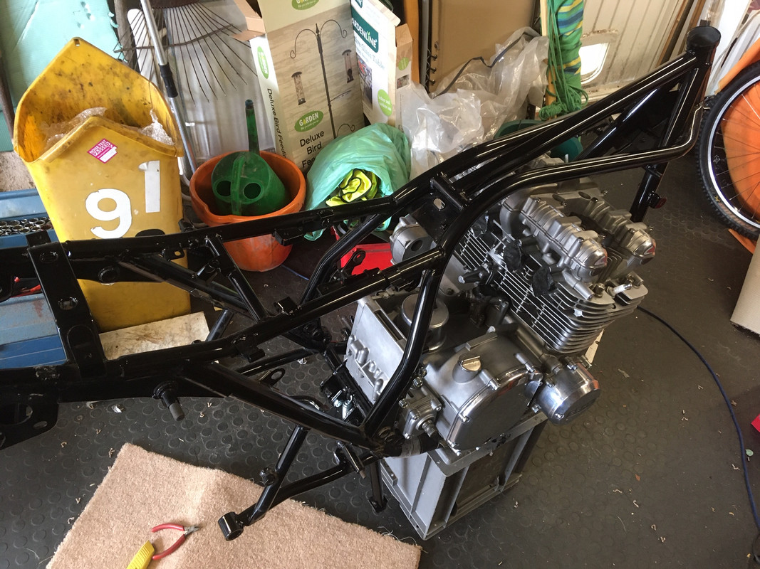

I didn't get it done myself, but when I bought my Z1 project the seller told me that the frame had been 'shot blasted' before professionally painting with gloss black. I was a bit alarmed at the thought of such a coarse media being used to blast a frame, but the finish is perfect, showing every tiny detail but no imperfections. It's also much more original looking than a thick powder coat.
Where it had been masked before paint, such as the threaded studs that the rear shocks mount on, there is very little metal 'missing' but a uniform matt grey finish. You can just about see that in the photo. Sadly I have no more information about who did the job, what it cost or what was used, but the end result was excellent.
