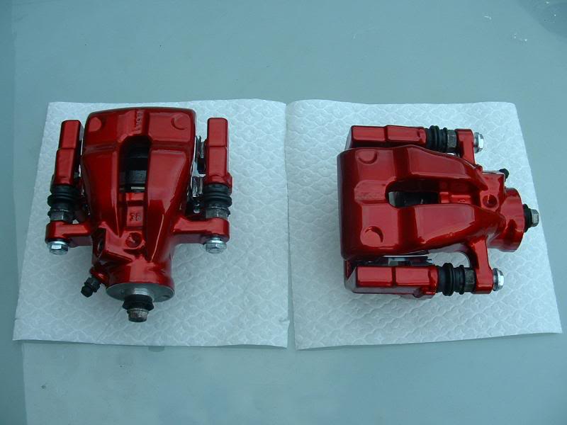

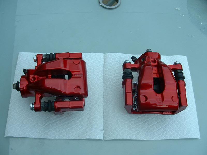

Phil, did you have yours done in Satin? I always choose gloss for frames, it's what on there originally and IMO it's the best finish for a frame. Seen a frame at TripleS done in Candy Blue, god it looked awesome. His Candy Red is awesome as well, I had some brake calipers for my Astra done in Candy Red and they still looked great 15 years later.
