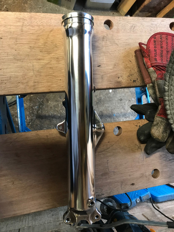

Just for your Roo.
Almost done, final polish needed and some work on areas where the polishing mop won't reach.

Shiney my precious!

That is fu£img mint. I’ve never been one for polish, but that’s too good for a Harrogate boy. Sorry Roo.

Hell! I had to fetch my sunglasses before I could view that Ken.🤣🤣🤣

Holy Sh*t balls Batman!
I'm astounded Ken, I think I agree with Phil! You might have well chromed them, theyre gonna look mint!
Well that has cheered me up no end, I almost smirked then
Thanks mate you're a good un.

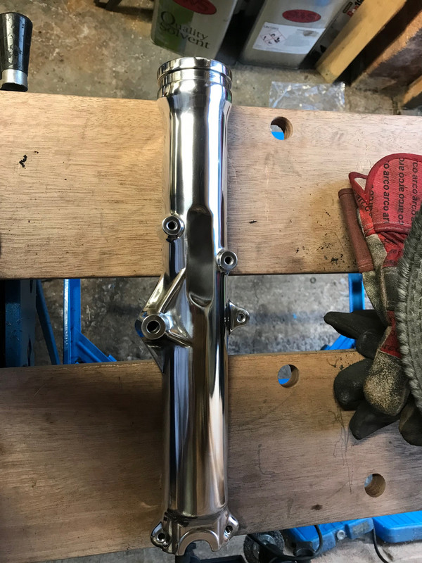

I’m not 100% sure but I think the other one is fractionally better. It’s come out pretty well considering but it does have a fault. Just below where the dust seal sits, on those 2 rings near the top, there is a dip in the alloy where I tried desperately to get rid of some pitting. I didn’t succeed and eventually just gave up and used another set of sliders, you can’t really see it as it will be behind the slider when it’s fitted, so too good just to throw away.
Just so you’re warned Roo, the other one is fine, it’s just this one that has that slight blemish
