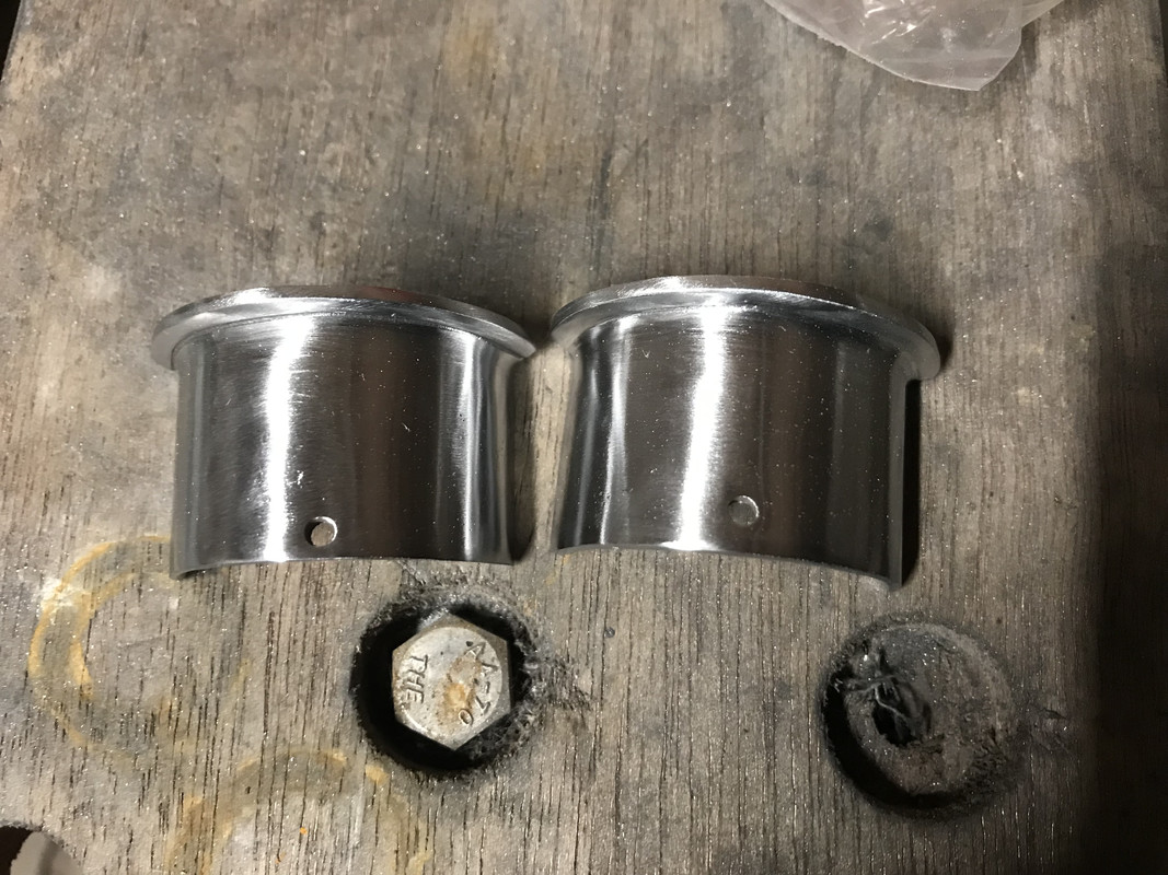

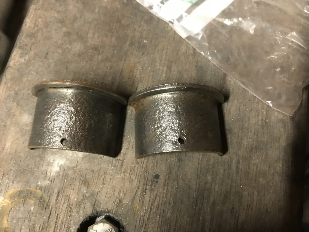

Finally got back in the garage after a week or so off.
Did your collets, just tidying em up ready to be done, need to be polished next.
Before.
After.
