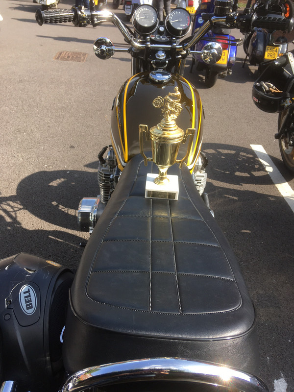

Back in September I took her down to the local BMPS annual show, a few years ago my CB750 won Best Japanese Bike there, the Kawasaki went one better and won 'Best in Show'!  :D I'm now retiring her from shows, while I have a 100% record - entered one, won one.
