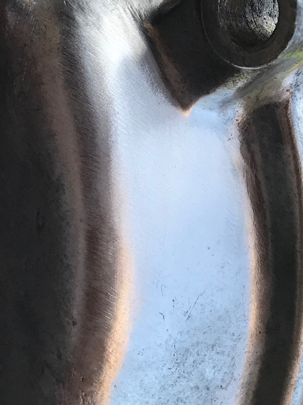

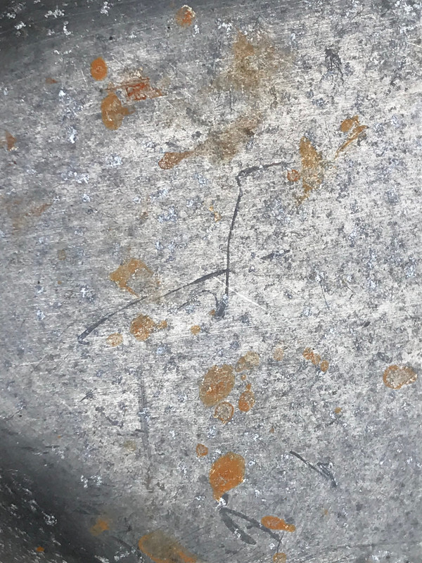

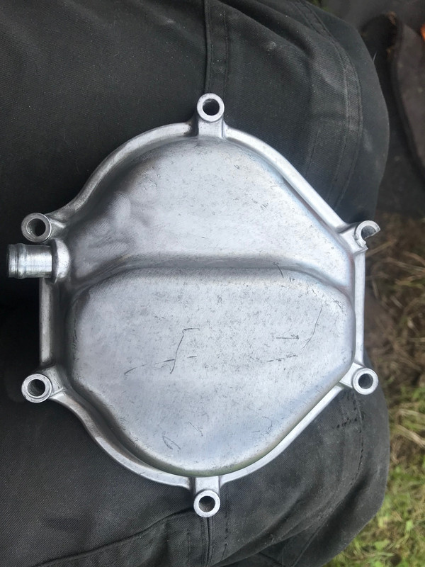

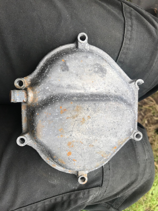

Just so you can see how good these discs are I thought I'd post a couple of pics of parts cleaned solely using them.
A 500 breather cover. Scrap as one of the screw holes is fractured off.

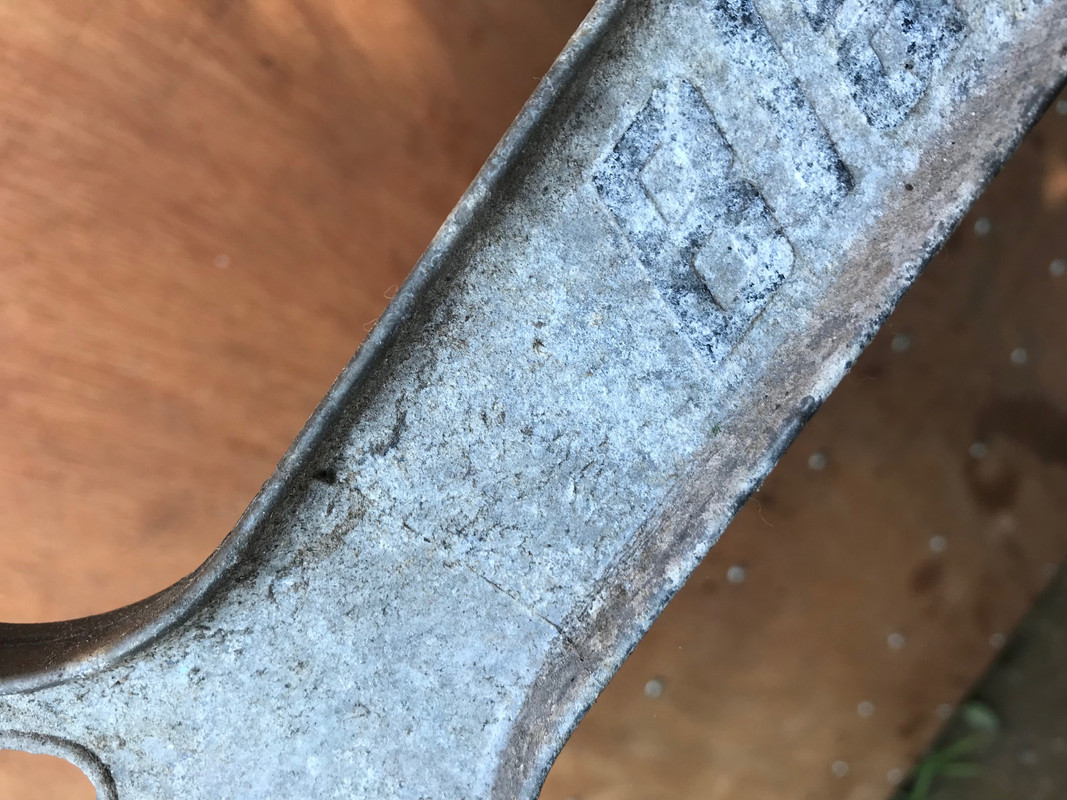

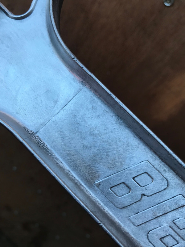

Before. I've included a close up of just how bad the surface is.
After. And a close up of part of the surface where I decided to see just how good I could get it without spending ages on it. It was badly dented. To clean the cover took less than 20 minutes, smoothing the small area took about 30 mins as it was pretty bad.

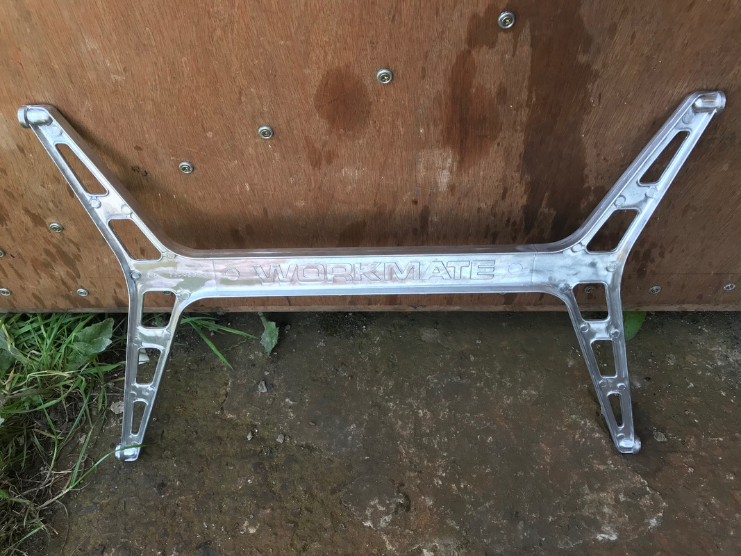

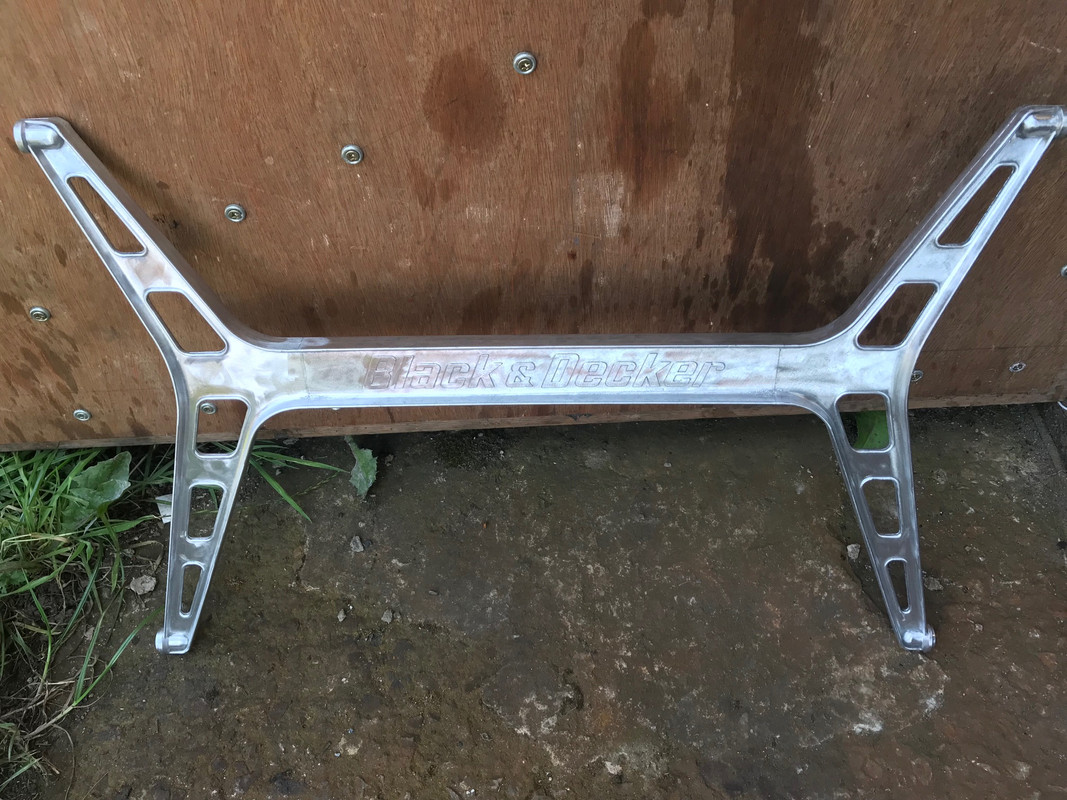

And my Black and Decker workmate I've started to do today. About 90 mins to do this. 3 discs on one mandrel and still not worn out. Still got the other one to do, then I'll fill in the lettering with black paint.

Dave they are the utter danglies, super chuffed and like the new presenter of "Pimp my Workmate"  said, cant believe I've never had any before. Well worth the tenner.

I've bought a packet of discs on your recommendation Ken. I'd be interested to see how you paint the raised lettering on the workmate.
Small brush, maybe a bit of masking and some black Hammerite. Simples  :) :)
I may do the insides and edges of the cutouts as well, should be good for a ton I reckon afterwards  ;D ;D ;D

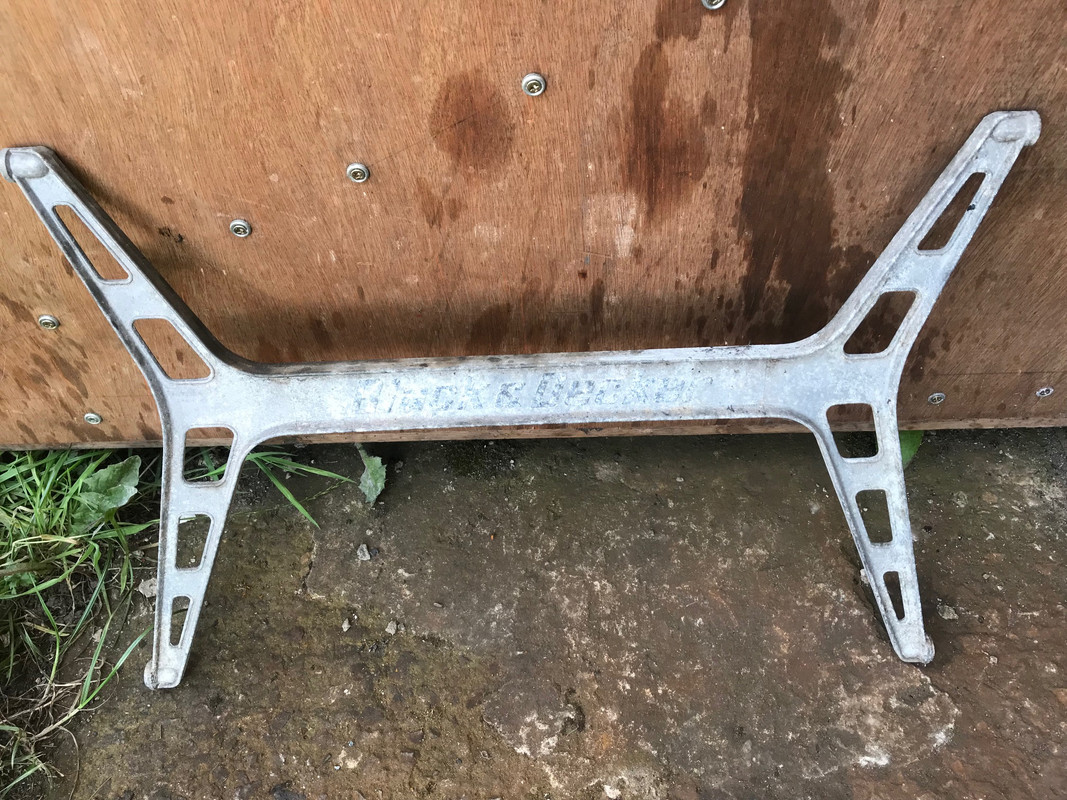

Workmate done with dark green discs, makes quick work of stuff like that and removed old plaster etc no problem. About 12mm big now though, so I'm using that setup for the flat parts and using a new 3 disc green for the tricky internal bits where you need the longer fronds to get into corners.
The one pictured was far far worse than the one still not done, that's now 60% done, had to pick up the missus or it would be done now.
