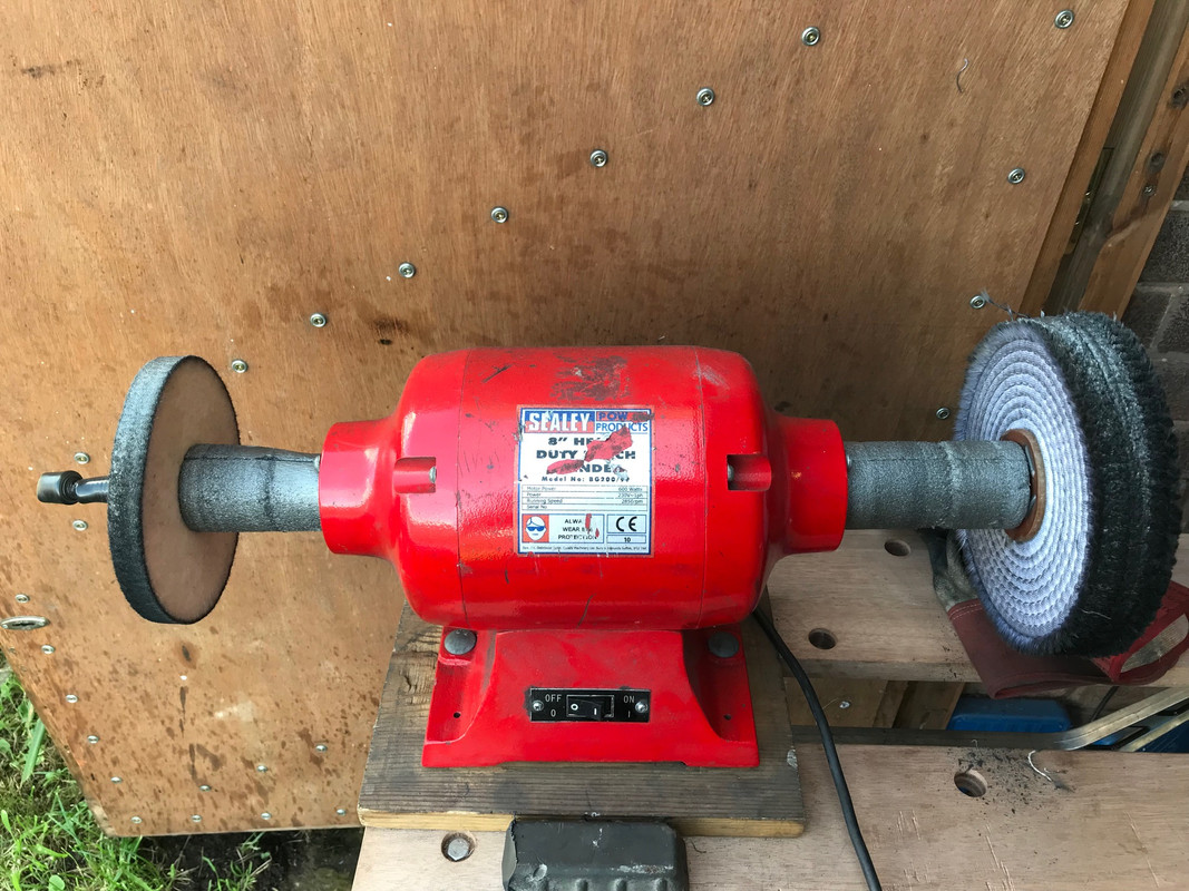

Just got my polisher out to do a few bits.
Here's what mine looks like.
On the left pigs tail is a felt mop which I use to do the first polish using grey soap, on the right is a close stitched mop which I use to do a polish for spotting areas not good enough, I use white soap on that one. I then resand the rough areas until I try with the grey soap again. Sometimes it takes 3 or 4 polishes to get it to my satisfaction. I have around 6 different grades of soap and approx 10-12 mops of various sorts.
The covers on the pigs tails are to stop the work getting damaged when it slips and hits the tail, the little bits on the end are for the same reason, I'd advise doing something similar to yours as the nut/end of pigtail can really mark a piece of work if your not careful

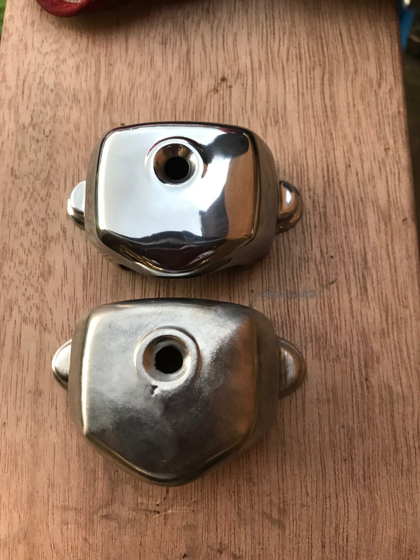

Just done a camshaft end cap off a 500/550, was pretty badly knocked about with lots of small dents, which are bloody awful to try and polish out, I've sanded them as flat as I can, getting rid of all the dents/chips and then do a few polishes to see how they come out. Some alloy seems to polish really well and some doesn't and takes a lot of work to get a good result.
I'll post a pic of both caps done, the one already done has come out really nice, like a mirror.

A Before and after pic, one done, one not.

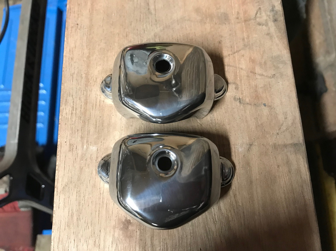

Both now done.
Came out ok really.

nice job, as ever Ken.

Look great Ken ... gives me hope for mine
