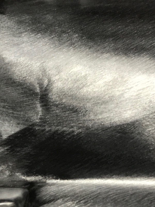

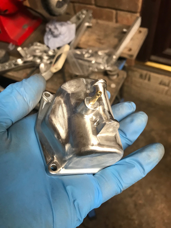

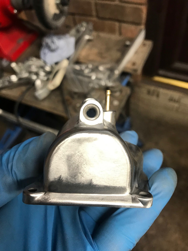

A couple of pics of stuff, to keep you motivated.
Before polishing, just flatted.
Notice the small darkish area halfway up and slightly to the left of centre. That's one of those mysterious marks that appear when you sand away the paint etc, it's some sort of stain or something, it will go if you work hard on it but best to see if the buffing removes it first.
Close up. It's not a dent or a crack, it's not caused by the sanding, it's some sort of casting stain I think.

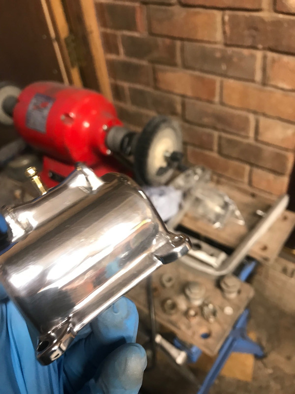

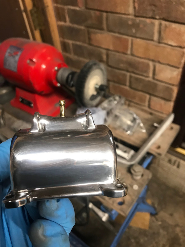

Not the same float bowl but it was in the same shape as that one, not final polished, just it's initial polish. The final polish will remove some of the very fine marks, hopefully.
