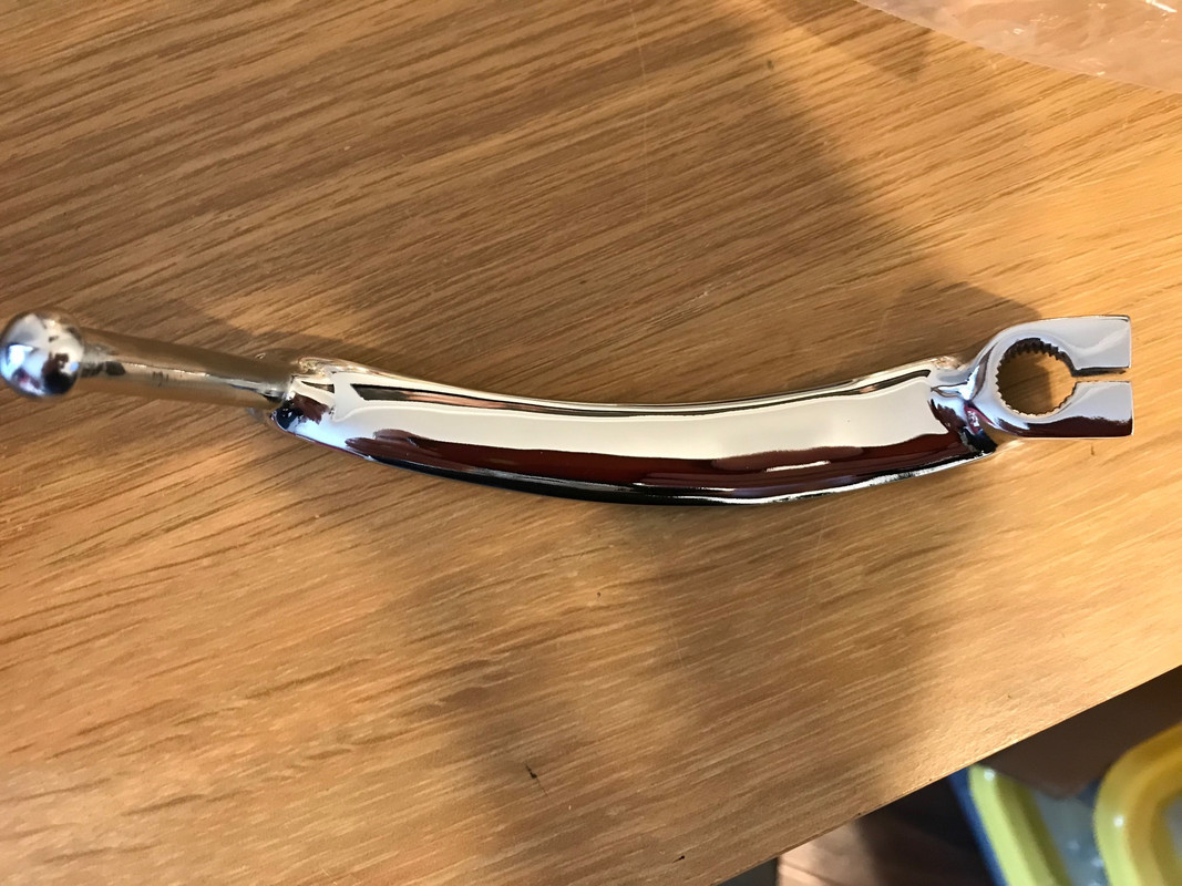

I think that because he doesn't have to get any of his employees to do any work on it that he does it for pocket money. TBH it's a decent job, not perfect but again TBH it's because I don't get the surface as smooth as they get them, mainly because I don't have a linishing machine.
This is one of the levers I had done.
It's more than acceptable in my eyes.

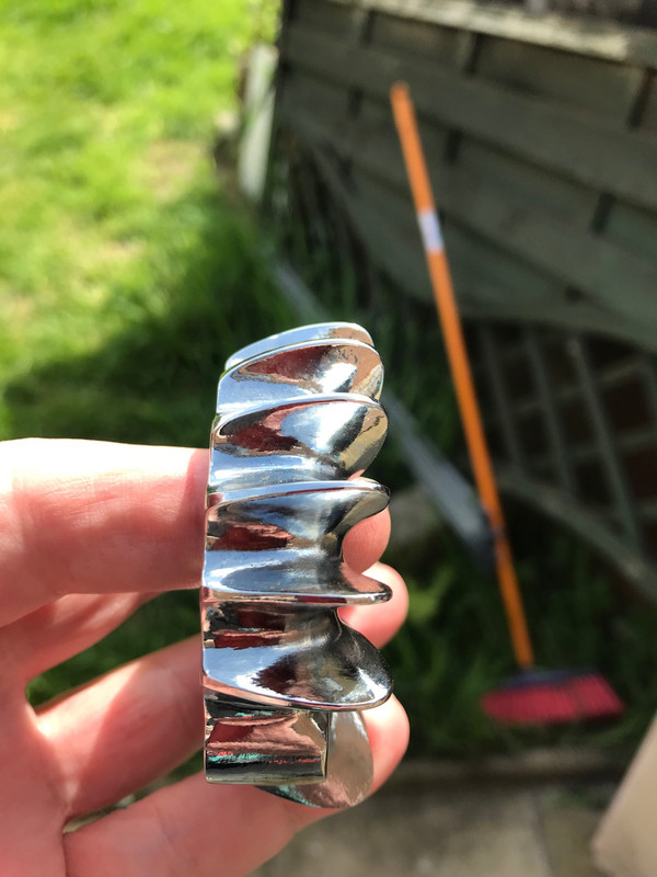

Oh and this is the exhaust clamp I had done as an experiment, to see how they would come out.
I'm having some chromed and some chrome ceramic coated, those are currently being done this week. I'll fit which I like best.
