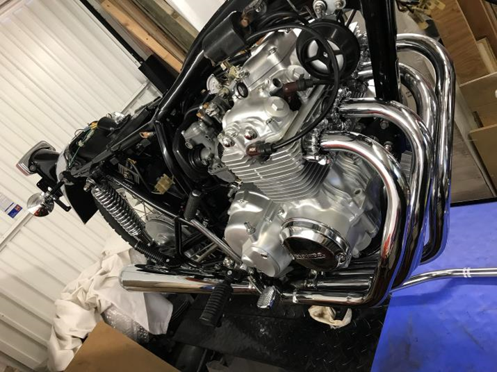

Hi folks, on to my next puzzle of "how the previous owner didn't put things together correctly...."
Can anyone help with photos of how the wiring harness is secured and properly routed on the nearside of the frame above the engine, and how the clutch cable is routed and any support brackets etc on the offside?
Thanks.

« Reply #3 on: March 21, 2023, 01:11:01 PM »
Hi Ted, yeah I was looking at those ones earlier. Do you know if the clutch cable guide is attached to one of the rocker cover breather cover bolts?  Looks like I'm missing the cable "holder" that goes over the nearside tank mount spigot....

« Reply #5 on: March 21, 2023, 03:45:50 PM »
Photo from a previous members  post of clutch cable guide in position.

« Reply #6 on: March 21, 2023, 06:55:44 PM »
Thanks Ted, that shows the fitment nicely. Clutch cable bracket is available from David Silver, that's where I got mine from. Cheers.

« Reply #8 on: March 21, 2023, 10:02:03 PM »
Here you go!
