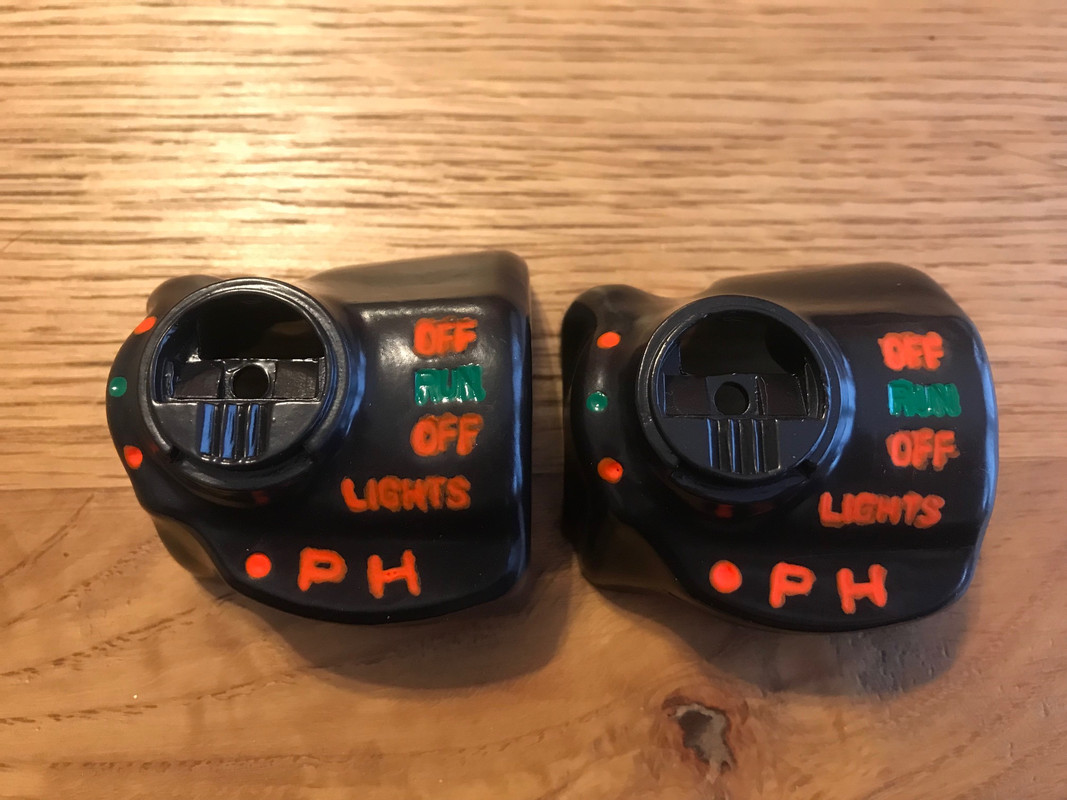

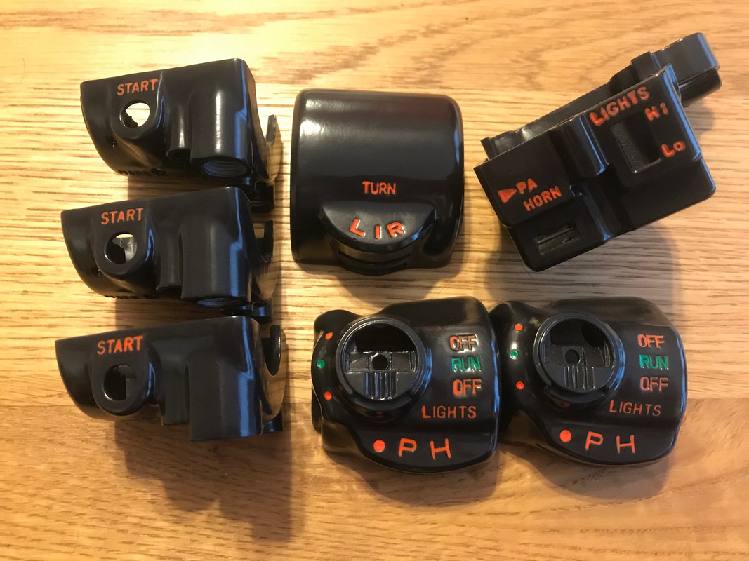

How can you tell? Very easily. The original switch doesn't have the dot coloured in red next to the P and H, the copy does. I don't think the quality matches the original Honda switches but it does the job and looks the part. If you want the throttle control system just drill the small lug on the bottom between the cable outlets 4mm, tap out to 5mm and fit the sleeper ramp inside the switch and the thumb screw and spring on the outside, I have them all NOS if you're interested. Comes in very handy on the motorway, just wind it in till the throttle sticks and you can avoid all that wrist stress of keeping it open, you can still operate the throttle if needed, it's just a bit heavy until you wind it back out again.
I've just done my switch halves again last night at 3am, filling in all those little letters etc. I often wondered why Honda left some unpainted but filled in the others, I did them all on my 2 R/H switches, even went further and did the run and it's corresponding dot in green as I think that's appropriate, green for go and red for stop seems to make sense to me. Just need to clean up the overpainting and they are ready to reassemble.

Just had a thought Martin, if the R/H switch you have is going spare I'd be interested. I'm trying to get a collection of broken switches and see if I can get some complete ones out of them, a little work and they'll be better than new and back into the community again.
Do something like this. Have them ceramic coated, repaint the letters, restore the interior parts and contacts, repair any wires that need doing, re-sheath the wires and then offer them to owners of our bikes.
