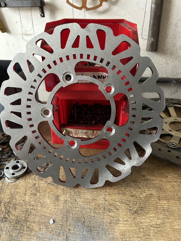

Here's what I'm thinking of, I'd just go for the outer part, the internal small blocks might be a bit OTT. I'm also thinking of doing the cuts in the outer part as well, that will really alter the look of a standard disc.

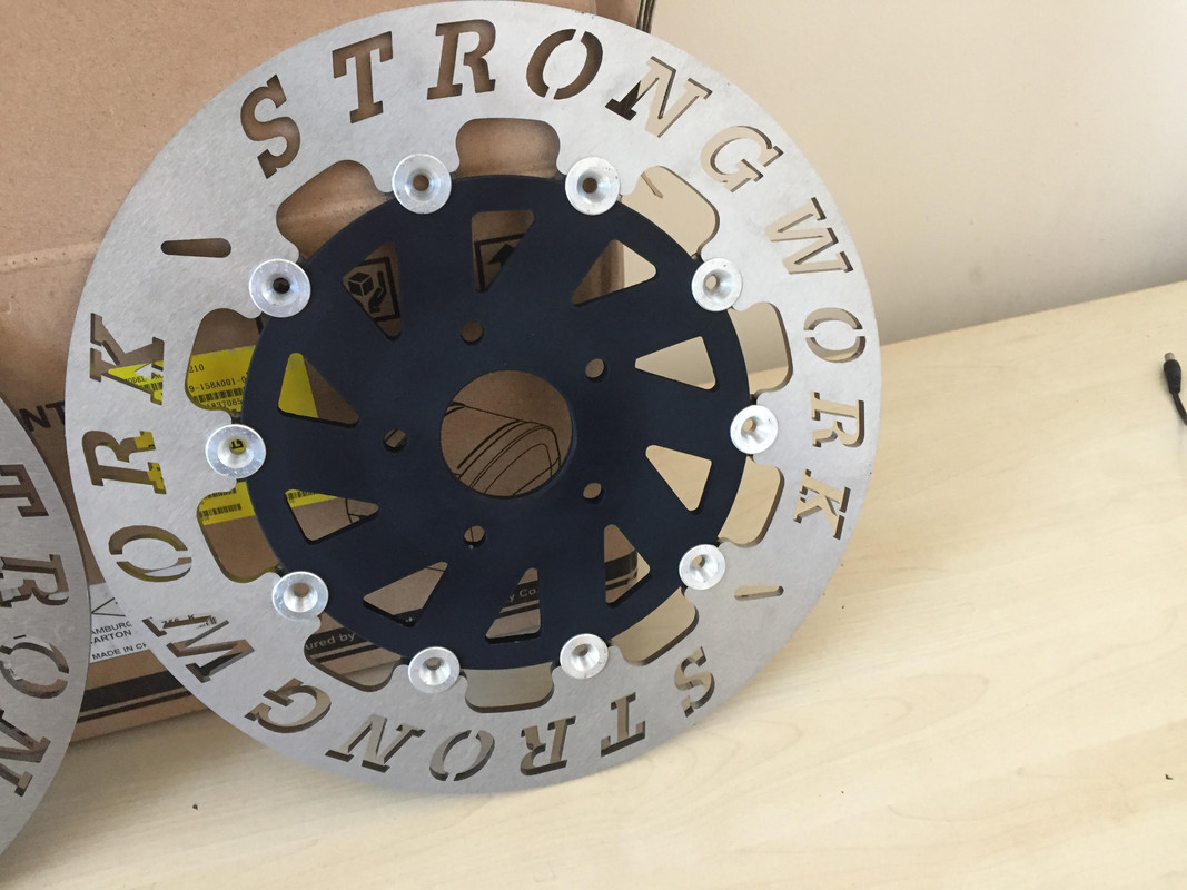

Just for a laugh, here's one he did for another customer. Really impressive job.

Wow they look spectacular.
Would they not cheese grate your brake pads at an accelerated rate?
I've no idea, just askin.

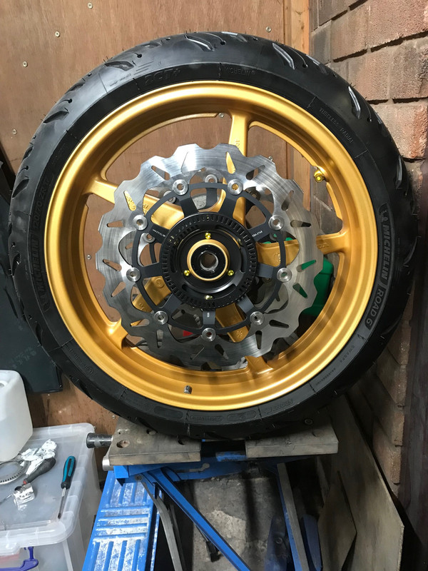

Modern discs seem to be very similar in design these days, so I'd imagine they'd wear about the same, maybe a little faster, I'm going with SBS ceramic pads this time around and I find them almost dust free and very good grip with prolonged life.
These are my new Galfer wavey discs as fitted to my 1300, not that dissimilar.
