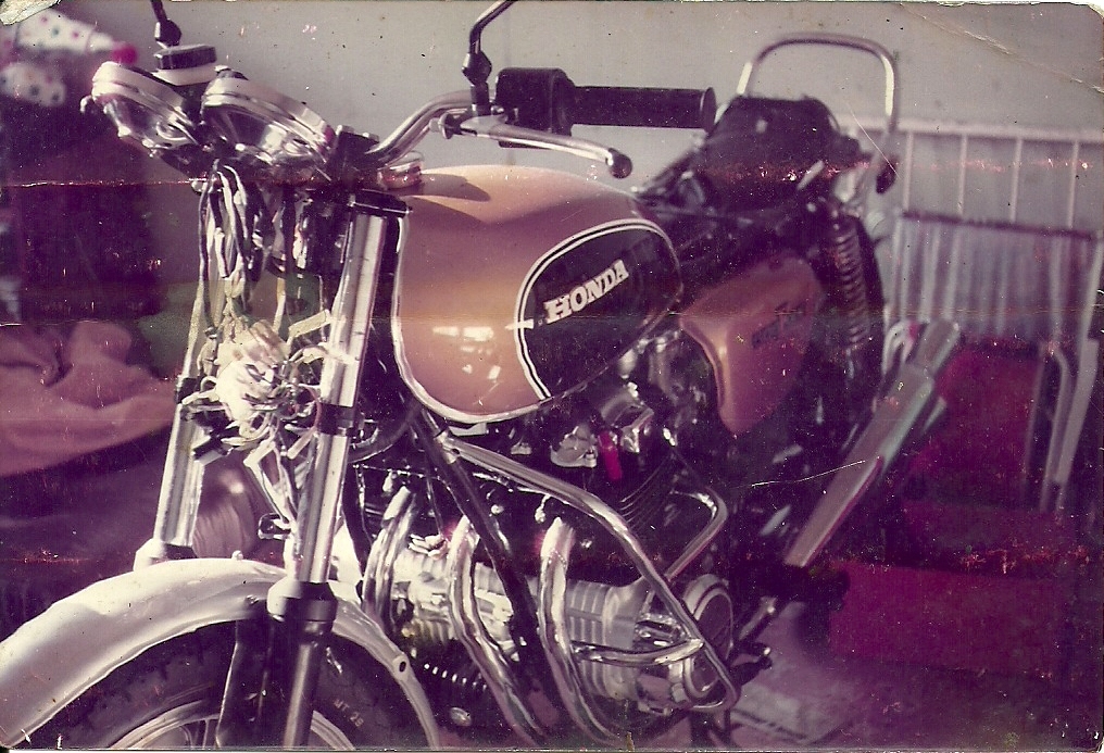

  • Posts: 4588
Re: 400f front mudguard
« Reply #14 on: May 04, 2023, 05:01:29 PM »
Here's a pic of my 500 when it was being restored, early 80s IIRC, the front guard is a mixture of 500 and 900. The brace is the original one from the 500 but like you I was finding they tended to rust in the middle of the brace, I think mud etc got under the brace, then water got into the mud and essentially made a mud pack, this held moisture far longer than just water would and meant it rotted the blade from underneath. So I cut off the chrome blade and looked around for a substitute, as I was still in the trade back then I took a front mudguard off a CB900FZ under insurance, drilled the rivets out and cut down the side plates so it left the same shape as the 500 chrome blade, bolted it to the 500 brace and no more rust. I had the blade painted to match the tank and side panels and it looked real nice.
I chose the 900 because it had a 19" front wheel so it was the right curvature. You'd need one with an 18" front wheel if you were thinking of doing something similar.
The only thing wrong with the 900 blade was that it had the speedo cable hole on the wrong side of the guard.
