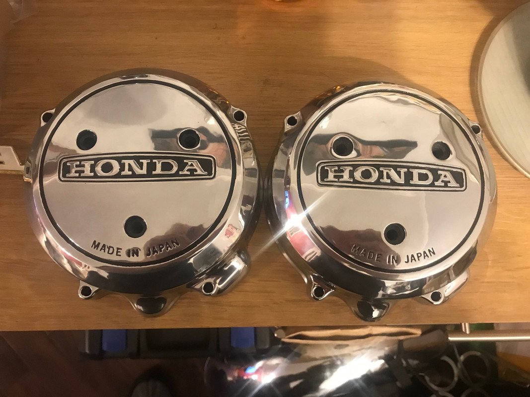

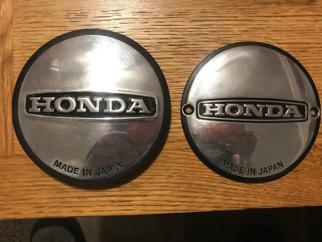

I have just finished the touching up of the 550 rotor cover, kept putting it off as I was working on another one and wanted to paint them together.
Finally finished both. This is the new one, already spoken for as a gift to another member.
And both together.

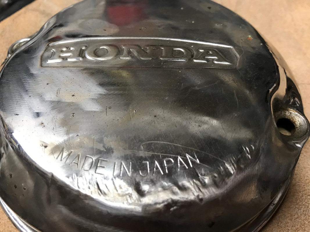

I had a go at this points cover, typical damage from being dropped. Not exactly in pristine condition, lots of damage.
And after a little panel beating on a silversmith leather bag filled with kiln dried sand. Just experimenting at this time, seeing if I can master the art. Nowhere near finished and TBH I'm not sure it's savable, there are a number of holes in the metal caused by small stones sticking into it, these have left holes in the surface, not holes that go through but I'm not able to buff these out. I'm going to try and fix them with some silver solder, flat it out afterwards and see how it looks and if it's ok I'll get it rechromed.

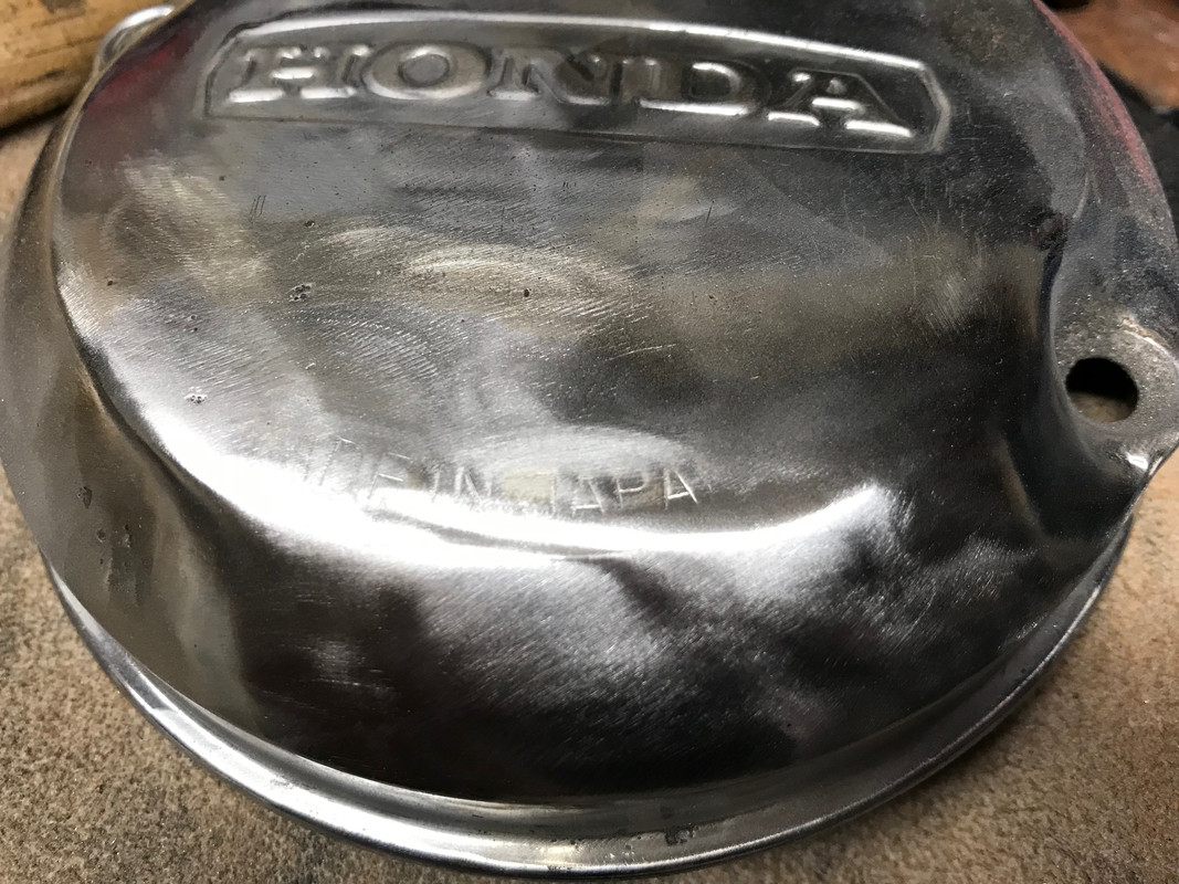

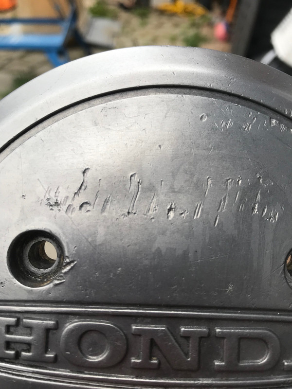

Forgot to post the before pics of the new 550 cover.
Close up, this area was actually dented inwards and took some knocking back out. You can actually see the line of the dent if you look closely.
There's a little of the dent still left, it's the right hand cover in the dual photo.

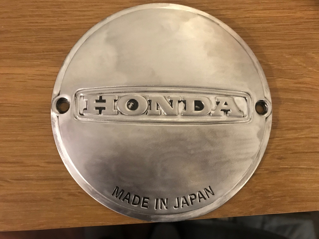

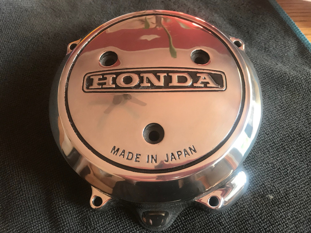

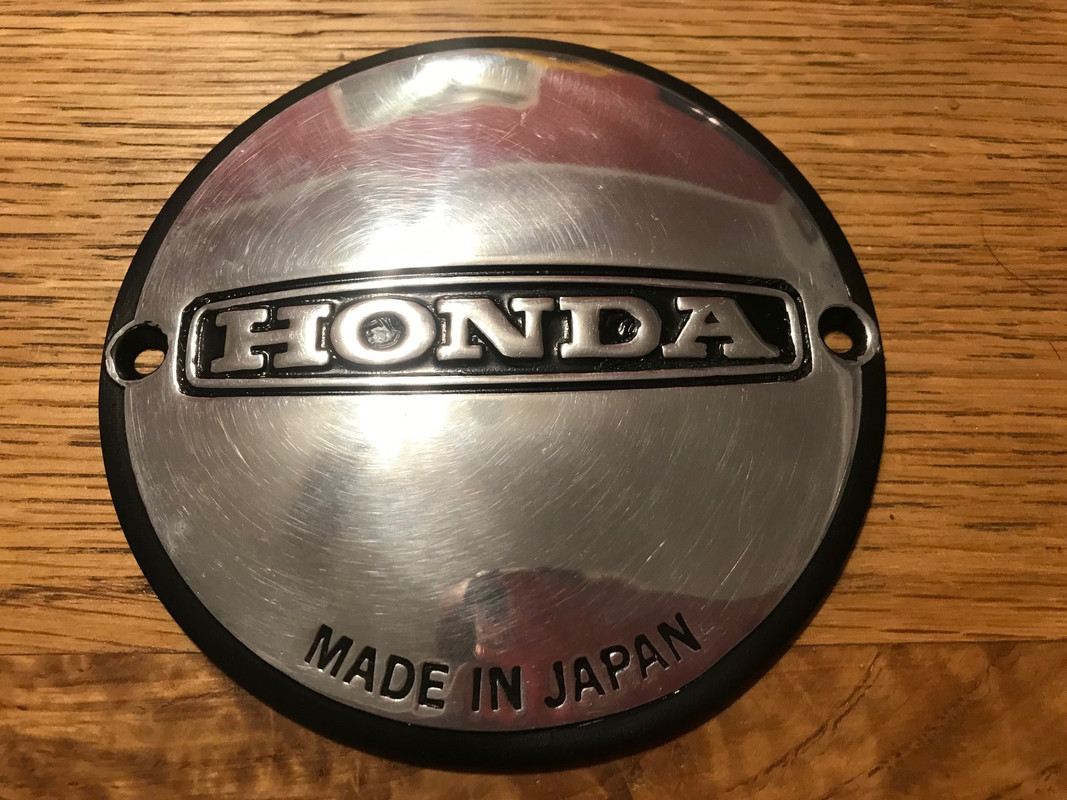

The 400 Four rotor cover badge is finished.
Started off like this. Some damage, not great but the dent in the upper half took some work to get rid of.
Then after being worked on, sanded and panel beaten to get rid of the dents, it looked like this.
I then started to polish it only to find it wasn't as good as I thought it was, so back to sanding and beating again. Then onto it's final polish. Some painting of the emblem area and finally the edge was sprayed in order to avoid brushmarks.

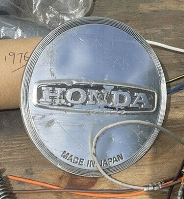

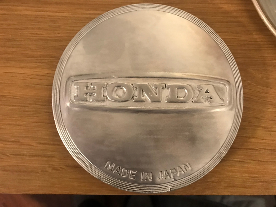

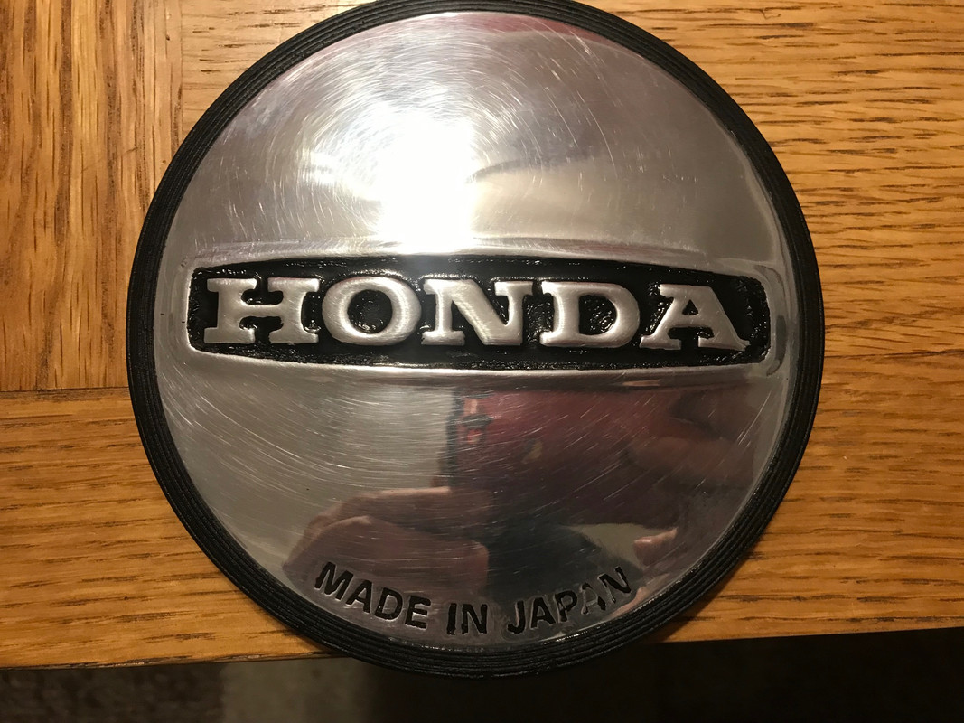

At the same time I was also testing my limits to see if I could recover this 500 rotor badge. This was bought purely to see if it was possible to do. It's actually a lot worse in the flesh than the pic makes it out to be.
Again, some panel beating and a lot of sanding later, again, didn't turn out too well on the first polish but it does highlight where you need to work on so not a total waste of time.
And after some more work.
I deviated from it's original look, the ridges on the outer rim were just left plain and initially I planned to see about just sanding off the top of the ridges so it was black/silver/black etc but I've left it like this at the present. All the damage was removed by running a diamond burr down the grooves to recut where the ridges had been smeared over by the damage when the cover went down the road. The black finish has covered where that wasn't a perfect restoration.
And finally both together. Just noticed I missed repairing some missing paint off the 500 Made in Japan area. No biggie.
