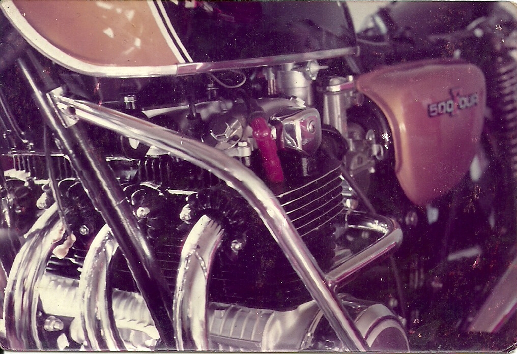

Was thinking when I was out on the Pan today if you had to get shot of all your bikes and could only keep one, which would you keep? For me it would have to be the Pan.
I would have to keep Millie the Mongrel 550. It's an absolute blast to ride, for a 550 the performance and handling are pretty phenomenal, the original Yoshimura pipe sounds fantastic, she has lovely styling and it's only a single seater, so I don't have to take anyone with me 😂😂😂. I love my 500 K1, she's such a classic but Millie wins my vote.
