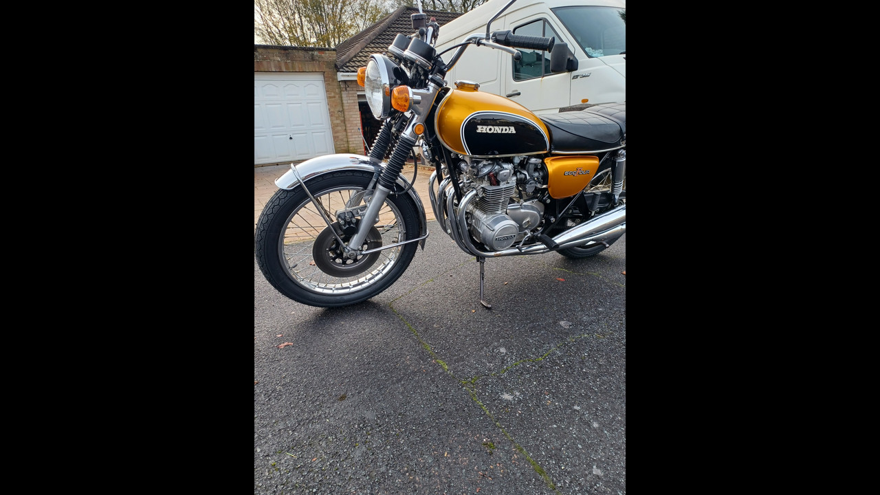

I did this by mistake when the wheel was off the bike. It allows the wheel to slop on the spindle so it would be bouncing between the brake pads. If you don’t note the orientation before disassembly it looks more logical to to have the nut end outboard. Thankfully advice on here put me right.

I still maintain it's possibly a 550F spindle
Look at this blow up .. you can see the tommy bar hole inside the hollow end  ;)

No it's not the spindle being fitted wrong Ash, it's the nut on the end, it's back to front, the nut part fits inside the fork slider and he's got it to the outside, that means the spindle becomes too long and hence why it's sticking out of the O/S fork slider.
Part 18 in your pic, nut on the inside, if you look at a pic of the bike from the nearside you can see the nut on the outside and a close up shows the spindle is very deep inside when it should sit almost flush with the nut.

Just to clarify, we are talking about the black 500 not the gold one. A look at the gold one, from the nearside, shows that if fitted correctly the spindle actually extends just outside of the flange on the nut.

Ahhh, that would explain it. The OP said spot the fault and then said the black one had a front spindle which protruded.
Gold one, spindle fitted correctly, look how the end of the spindle protrudes. Nut part on the inside.
Black one, spindle right down inside the nut and the nut part on the outside.
