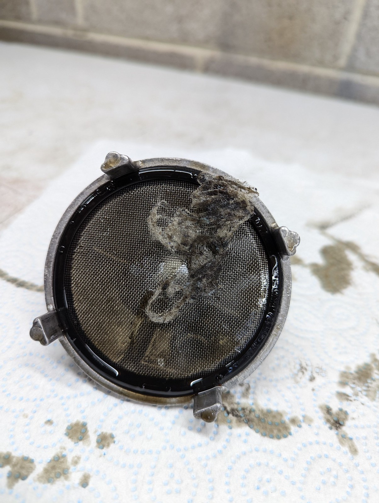

I would take care trying to remove the mesh unit as the outer rubber section  might have  become brittle with age.
Mine was full of filter mesh that cleaned off easily enough by squirting down cleaning fluid from the top.
IIRC if the seal part breaks  replacements might not be available.
This was mine - cleaned easiy without removal - assuming yours is like mine.
.500 mesh filter by Macabe Thiele, on Flickr

« Reply #3 on: September 20, 2024, 10:24:42 PM »
Yes that’s it Ted. Thanks for the tip. Thanks for the reply too Julie; did the ‘yes, refer to the removal/ replacement of the oil seals. Mike
