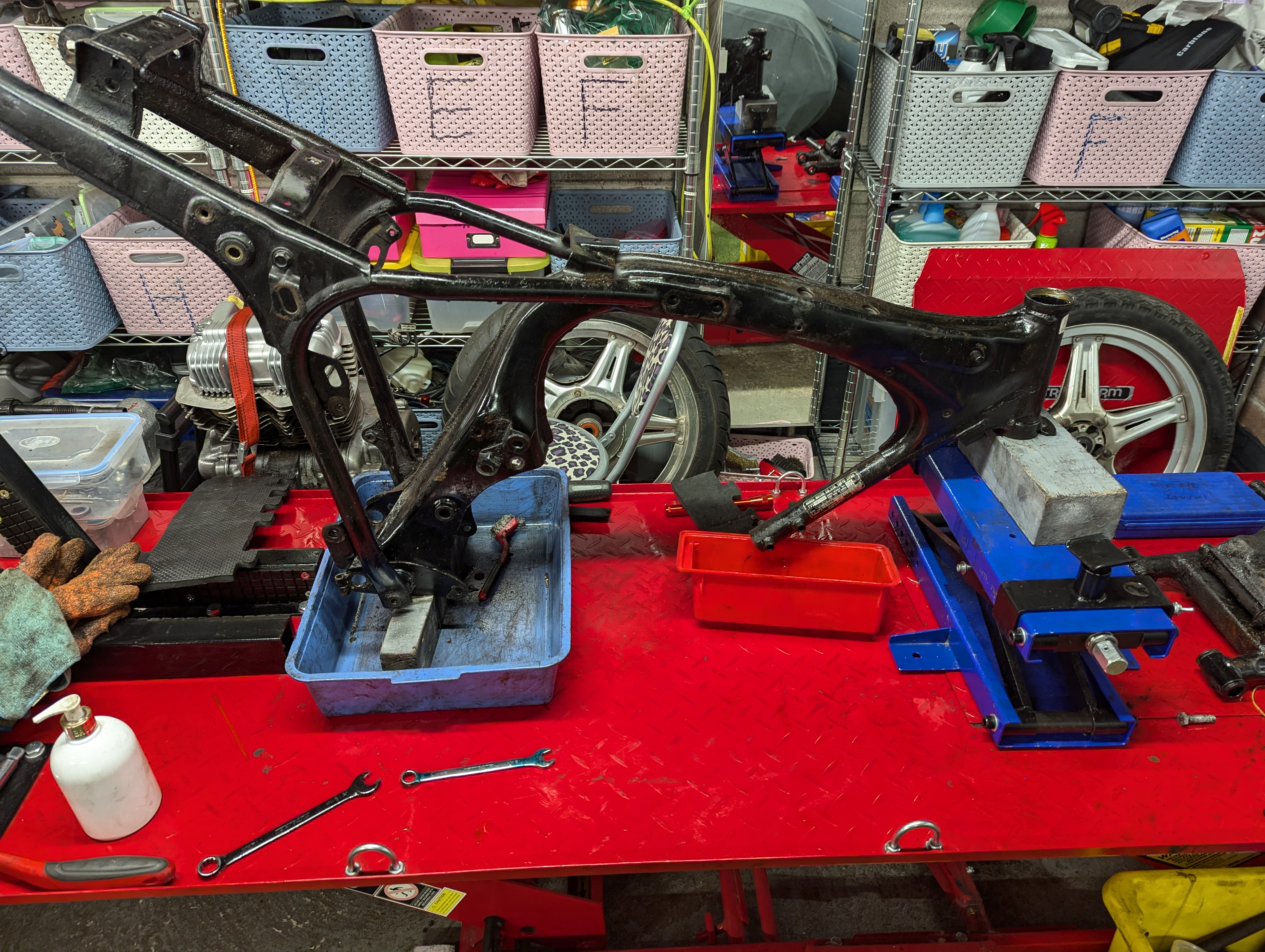

Down to the skeleton now.
.PXL_20241111_200316917 by Macabe Thiele, on Flickr

Dave - is £100  to check and straighten it as well?  Was that a spot on Watford?
Hi Andy.
The price included minor tweaks although if the frame is bent and needs heat it will cost more. The 350 Morini frame I took to him needed a crack on the rear seat rail welding up and that cost a bit more.
Howard who owns the business is very honest and is an ex aerospace engineer. He was building a wicked looking Norton Commando cafe racer in a Featherbed frame last time I was there.
The company is called Hybrid Motorcycles and they are located in Croxley on the road between Croxley and Sarratt. It is opposite a prep school and is just a driveway, blink and you'll miss it!
