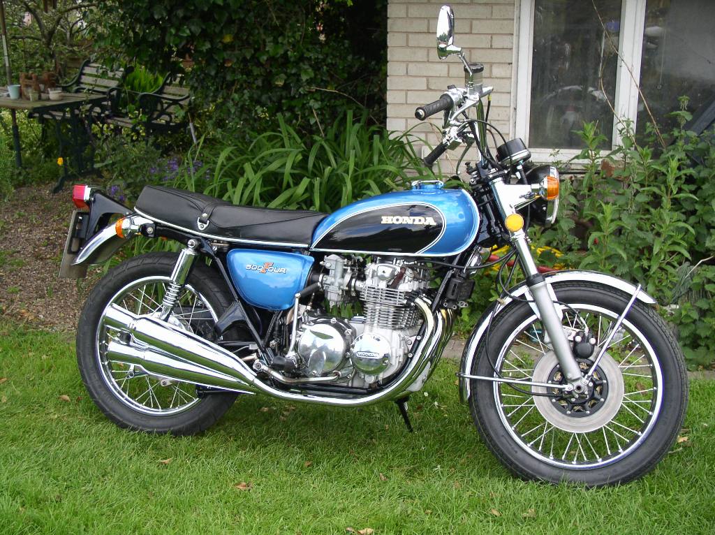

TA dah...!!!!! was MoT'd this afternoon and ready to go...well almost ready ...just a polish up and few things here and there.

Nice on Cyril
, thats a beauty
there was a very tidy Brown one at wednesday bike night if its there next week i'll get a photo of it for you,
so you off to the TT on it ?, cheers Mick.

Very nice, you done that really quickly, i hope you get to enjoy it with this really good weather we are having

Nice job, that looks great.

Oh yes definately off to the TT on it next week now....been blasting about this afternoon, firing it upto red line and well over 100mph, she's flying.
Certainly cooked all the engine paint but also annoyingly have some leaks...one fork seal is pissing it out like it hasn't even got a seal, one cam end cover is leaking slightly, its one that i swapped because the one on my other engine was less work to polish, oh well Ive some new orings somewhere. Also one of my tappet covers has a large crack half way round it that I never spotted when i blasted it.
Will order some proper Honda fork seals and send yet more pattern tat to my scrap heap, I'll fix the other leaks in an hour or less. Very pleased with it. Have to fit my screen though, the wind at high speed is horrendous.

that is one fine looking bike, well done mate
