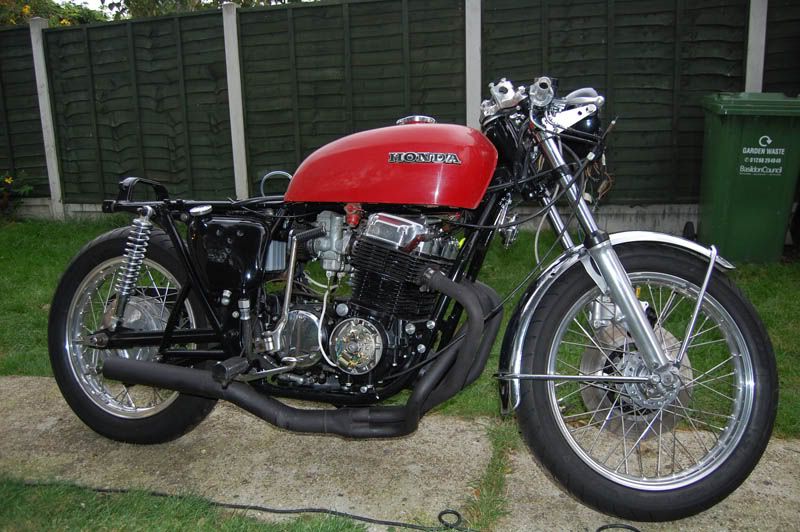

Dragged the CB750 out of the shed today for the first time in over a year, I have never been able to ignition time 1 and 4 unless the backing plate is turned so far around the screw holes do not line up on the two lower screws ?
I have removed the backing plate and as far as I can tell it can only go in one set position in realation to the points cam lobe due to the dowel on the advance and retard mechanism.
Any ideas ? or am I being really thick ?
The red arrow on the image shows how far out the screw hole is.

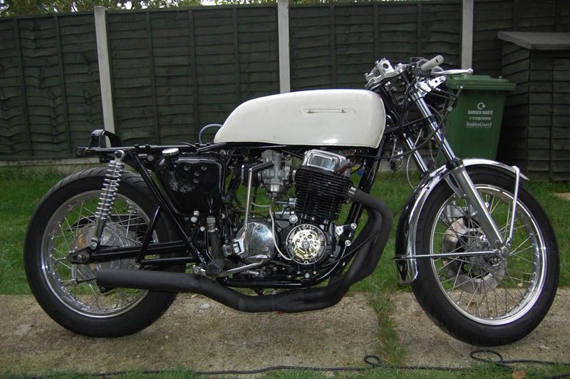

Yes I have seen that before, but i am a bit reluctant to cut up the early "K"series right hand tap tank that I have, the "F" series tank was cheap and cheerfull so i won't mind having a go at making it longer as in my dodgy artists impression.
