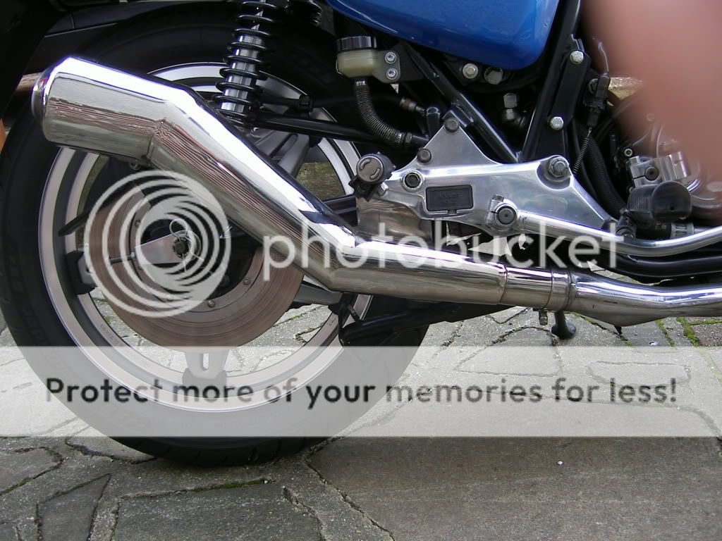

I dont think the log book will say its a PPR anyway, it will probably just be registered as a Honda cb750, wether its original ppr or not does not make a huge difference, as they are simply a 1978/79 F2 with a few bolt on changes, they came with Girling gas shocks, rear sets using redrilled original hangers, complete fairing , a seat and tail piece,front guard, a very unique set of ace bars, ignition switch mounted in the left of fairing, and of course the lovely hand built ally tank, as long as you have or get the above on your bike it will be as good as any thing else out there, there have been a few in recent years on ebay which although original have lots of changes, the exhausts rotted away in the first couple of years and so most are hand made sort of copies, i have two pipes actually one is in ordinary steel not original but looks good and the other one i had made per spec from stainless steel i have a picture of my stainless one for you to see below it is at the moment on my F2,

Your exhaust looks great! A quick spray of black engine paint and no-one would tell...
