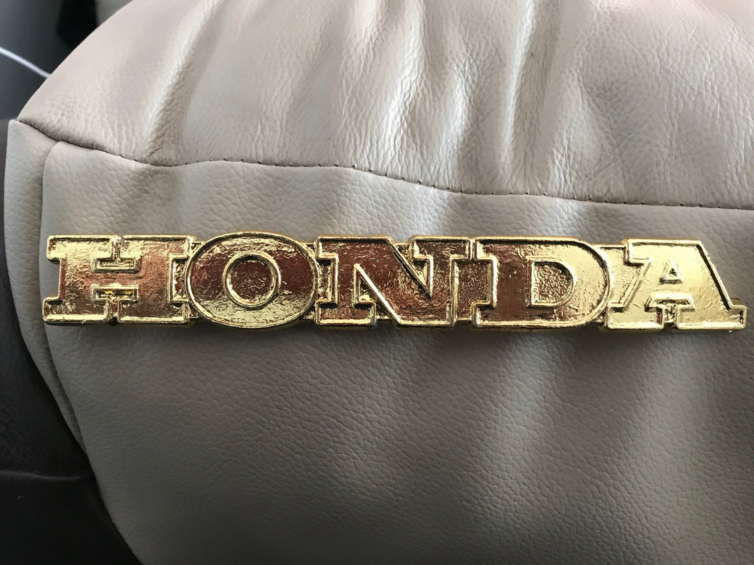

I don’t Phil but on that particular post which I forgot to reply to, I went off and tracked down that clear gold tint but it’s acrylic so even with a good dollop of petrol safe laquer it would fail fairly soon. Shame as it would have been the dogs too.
There must be anodiser’s up your way surely that would do it? I could ask my pal Lard up in Harrogate see if he could suggest someone? If yer stuck?

Thanks Roo. I’ll take any leads I can get. I’ve been to two potentials, but the job is either too small or too expensive. I might have to source some new ones, if they exist.

The metal is what I think is described as Pot Metal, which means essentially junk metal, I'm doing a badge at the moment but currently sidetracked on a set of carbs for a member on here so they've had the gold part done but not the white or black, the gold came out really well. Thinking on about petrol, I may have to lacquer them in satin or matt petrol resistant lacquer when they are finished.

…what’s the gold finish Ken??

24K gold leaf Lobo. Thought I'd give it a try, never know until you try something.

20 mins of Synstryp later….

That looks like the sort of stuff you don’t want in yer eye then!
Paramose would have done that in less than 1 minute !!

Same with Synstryp, but I was having pint 😁at the time.

Probably the same formulation then Methylene Chloride + Formic Acid (ant bite)

Quite possibly… Methylene Chloride (Dichloromethane - DCM) Methanol Phenol Formic Acid Acetic Acid
