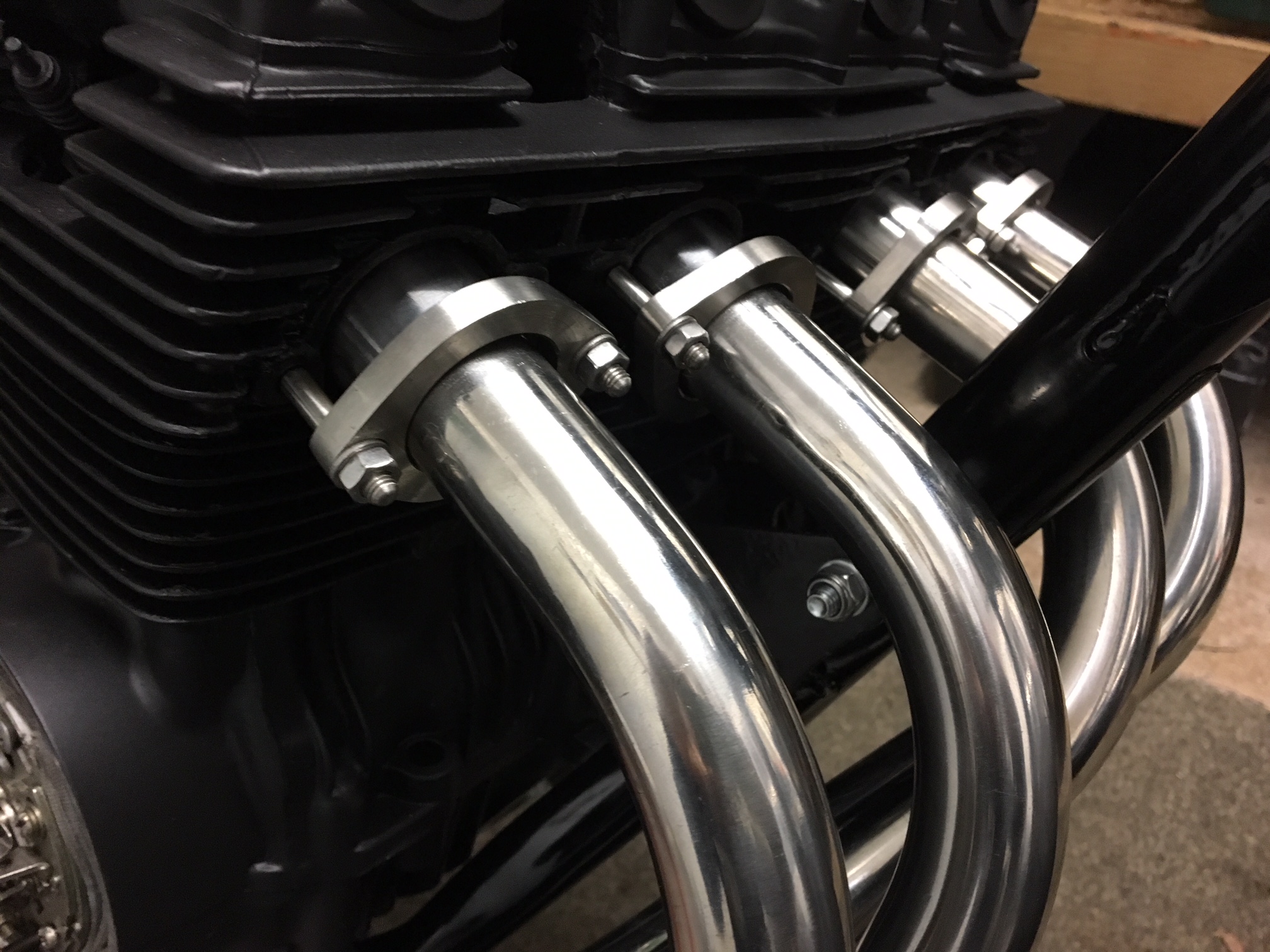

 Good luck with the rebuild, I'm slowly rebuilding my CB400/4 had the same issues, in the end.. the exhaust stud came out with penetrating oil and lots of heat and very very small movements... it often helps trying to tighten the bolt as well.
I had the same hole in the frame, had it welded and the frame sprayed rather than powder coated.
My new ss studs.... :)
