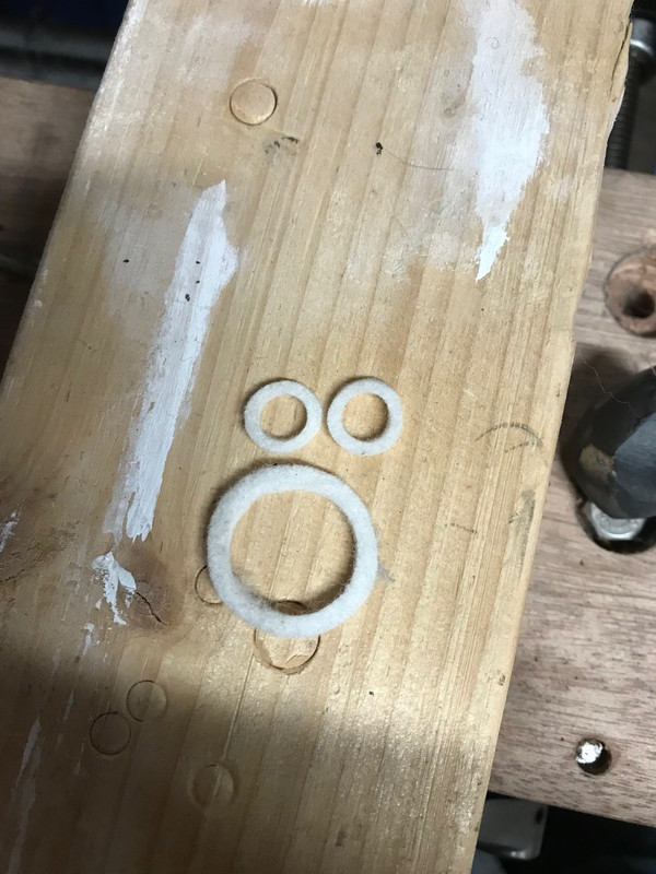

First attempt.
One problem, whilst I can do a 26 x 20 felt washer quite easily and a 12 x 8 easily I have found I cannot do the small ones for the choke as the cutters for the 10 x 6 that they require both use the same mounting position so I cannot cut them both at the same time, unlike the others. Plus after checking a 500 carb body it would appear that the 500 is the same size as the 400, the problem is 9mm is too small and 9.5mm is fractionally too big. The shaft is 6.8mm. There are no 9mm cutters in the set.
Looks like I'm going to need to get creative.
A swinging arm washer and 2 lifter washers. I didn't hammer hard enough for the swinging arm one, hence why it's a little fuzzy on the inside edge. They do seem a lot more robust than the previous ones I made by hand.
