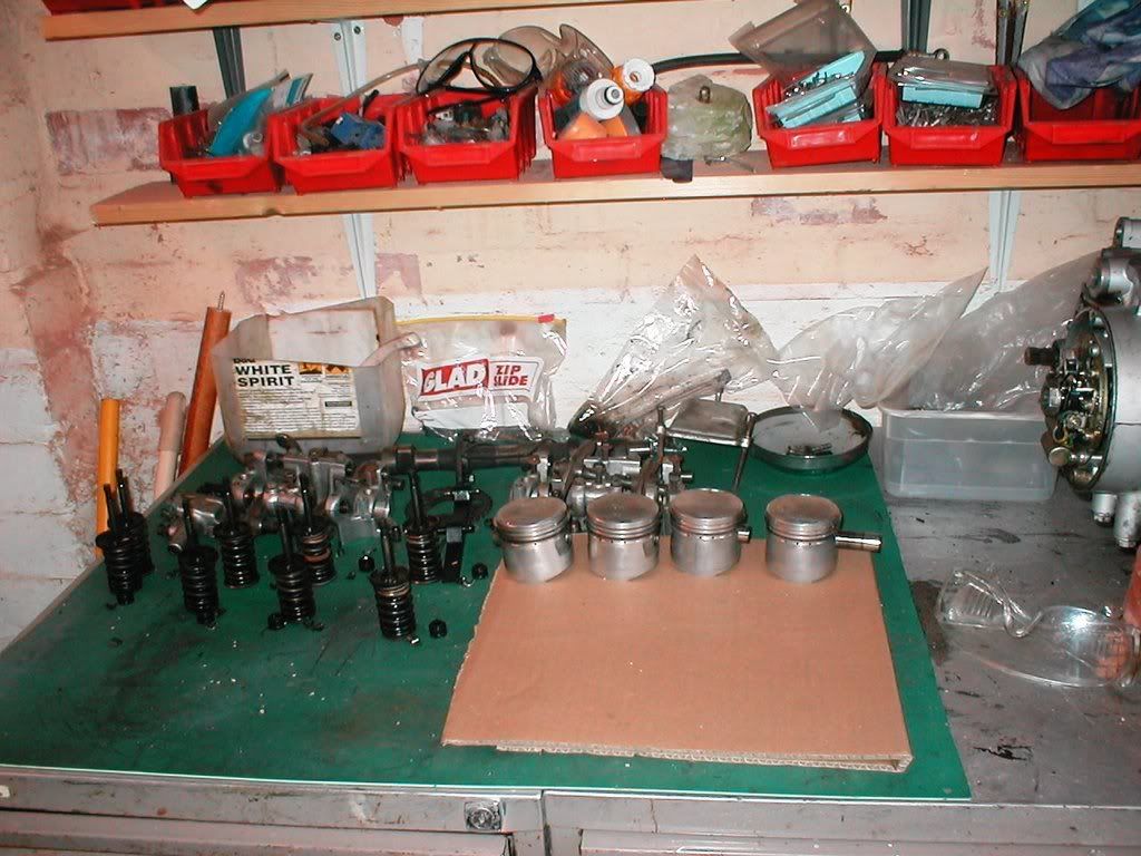

I had to rebuild a couple of years a ago, on My F1 ('76) I had a "squealer!!" The cam had seized in the holder due to oil starvation. When I dropped the oil filter there was so much metal in it the oil looked like silver paint.
I've had two cams fail though oil starvation and I once bought an engine for spares and it had the same problem, but I've never seen a snapped camshaft, I'd like to see a pic of that.
To do the job properly and still have faith in the engine afterward, you really need to get a camshaft AND cam carriers from the same engine, you'll know then that the wear will be even.
I would, (and did) do a complete engine strip, and took the oppertunaty to check all the other bearings and clean the crank cases of any dirt.
As Steve said check the piston crowns, and valves for damage, a new pistons are around but cam holders and caps are a rare as rocking horse sh*t.
