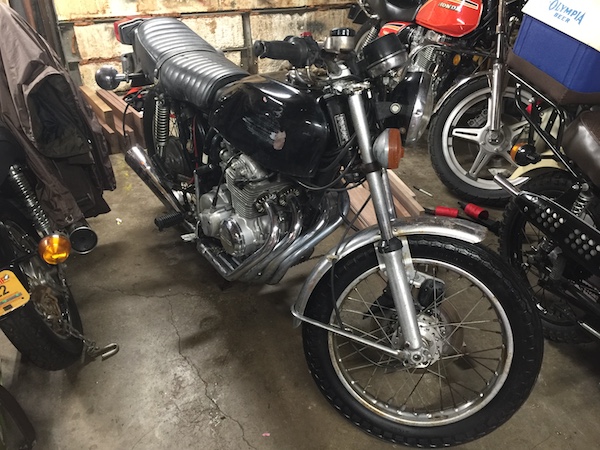

Then a 1975 CB400F appeared on Craigslist.  Here in the States the 400F is pretty rare compared to other Honda models.
I wasn't going to pass up the opportunity to have a "Holy Grail" parked in my garage.
It was located about 6 hours away in Iowa.  So I took off work early and started my adventure.
I found it in rough non-running condition without a title.  However the price was right so I made the deal and she followed me home.
I got busy w the usual preliminary checks...looking to find why she was parked in 1998.

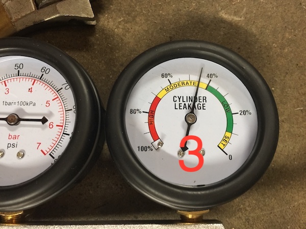

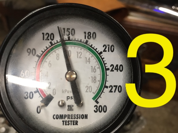

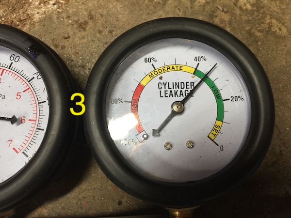

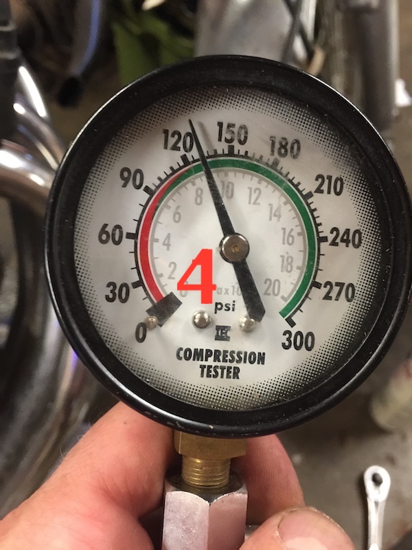

I did leak down and compression checks and all four came out to be about the same..
Not the best.  But, good enough to run, for now.

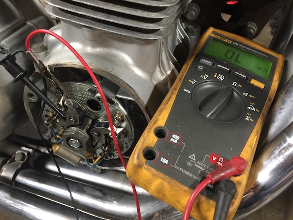

The previous owner had told me the coils were bad, it had no spark.
I found it was just dirty points.  So I got them cleaned up, set static time and found spark on all 4 plugs.

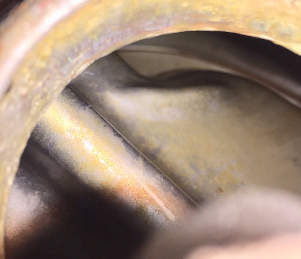

Dumped gas into her dirty tank, cracked the overflows, and found it made its way to the filthy carbs.

Next I oiled the chain, added some air to the rotten tires, etc etc...  then on 1 1/2 maybe 2 clogged carbs I went for a ride.
https://youtu.be/6TxcUfywY9g
I now knew I had something I could work with...

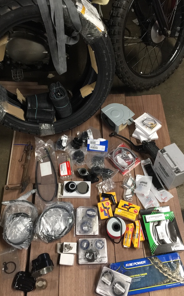

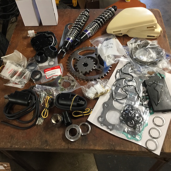

So got busy ordering parts and parts and more parts.

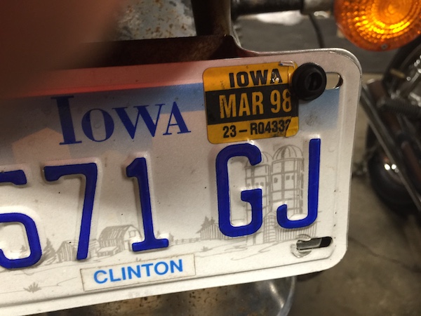

That looks like a good starting point for a resto. Some of us start with a frame and boxes of parts!
The old plate has my initials GJ, I don't suppose it's for sale, is it? 😎
Thanks, and YES, let me do some digging.  If I still have the plate I will be happy to send it your way.
Please PM me your address.

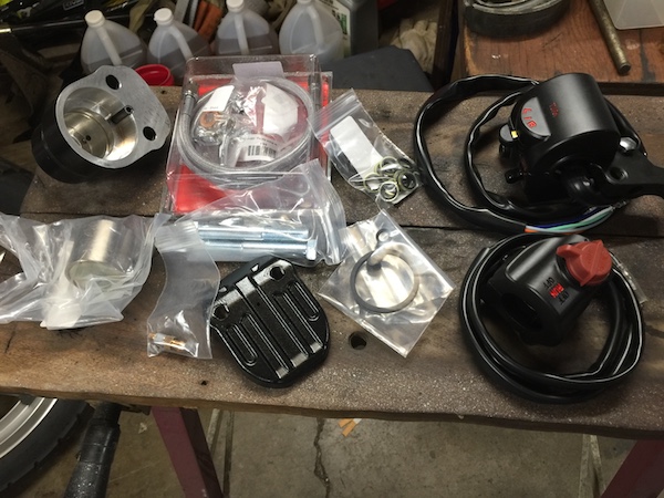

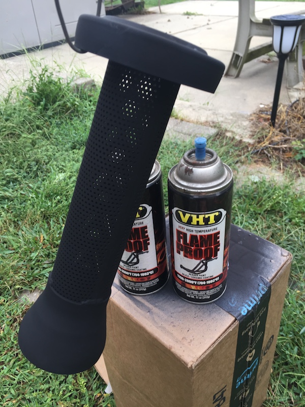

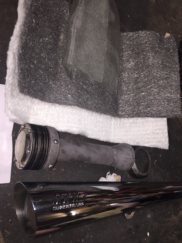

Picked up some necessities on ebay...

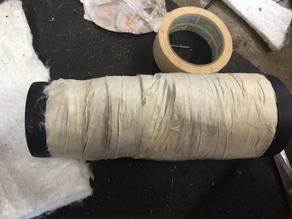

Ebay (almost like new) 4" Supertrapp megaphone complete w 18 SS tuning discs.
And a SS Wool/fiberglass blanket kit from International Steel Wool.
Sand blasted and fireproof coating
single layer Masking tape wrap help keeps the packing in place for easy install.

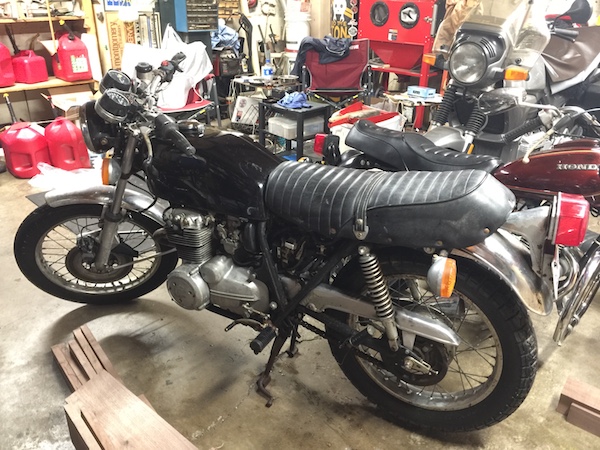

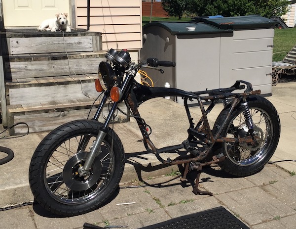

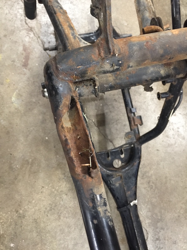

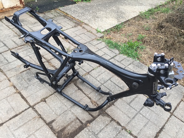

The kickstand had rotted off the original No-Title frame.
Picked up a really nice frame with a Title.

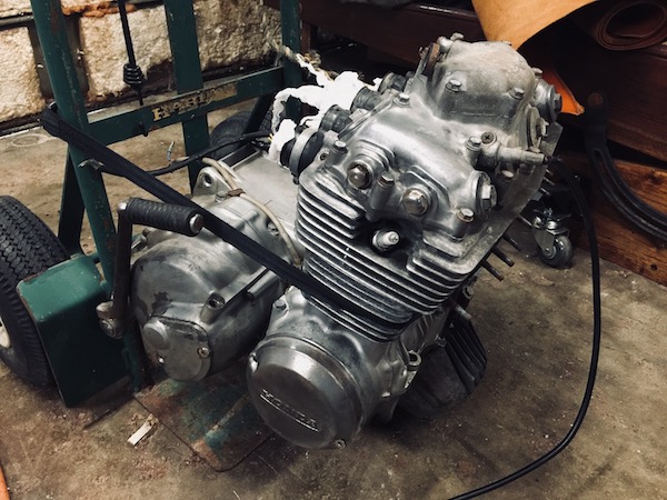

Found a good deal on a spare engine with 11k kilometers on it.
At least the numbers are better.

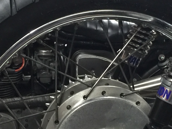

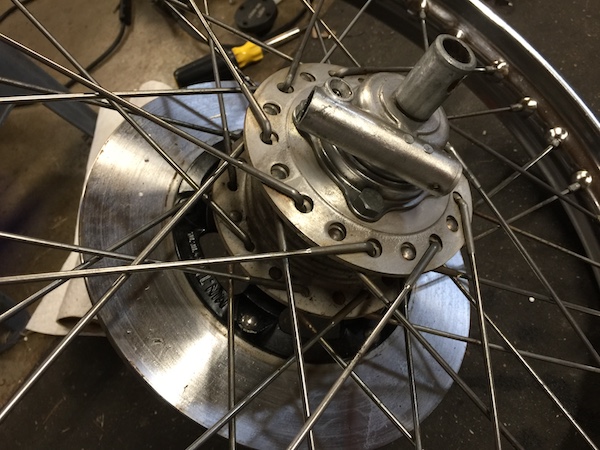

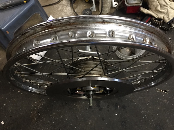

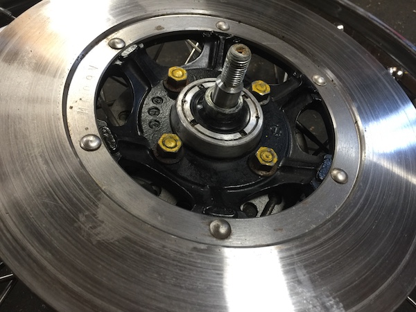

Both rims were bent.
Super nice NOS front complete w disc.

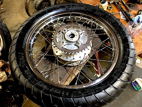

and nice new rear.  I Installed new bearings, sprocket and tires.
The weathered spokes on the rear wheel polished up as nice as the front spokes.
Ceramabrite glass cooktop cleaner is the stuff to brighten old finishes including chrome.

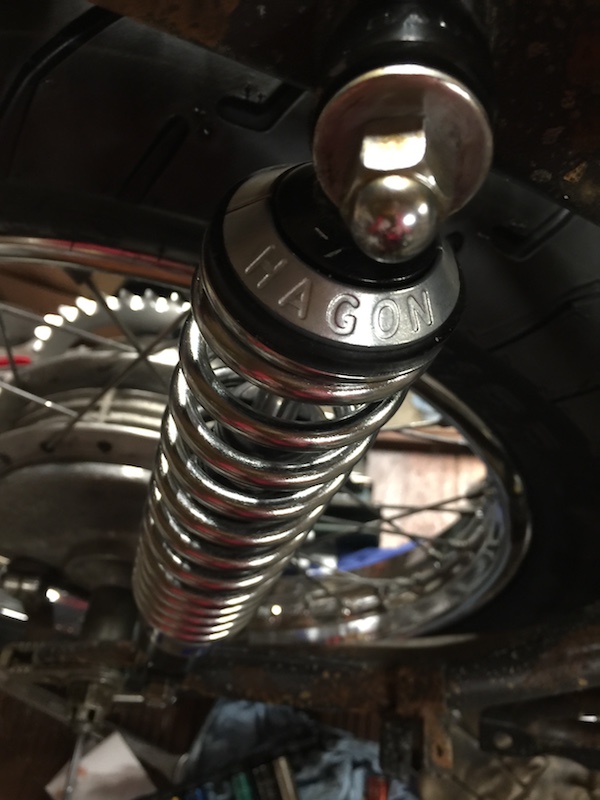

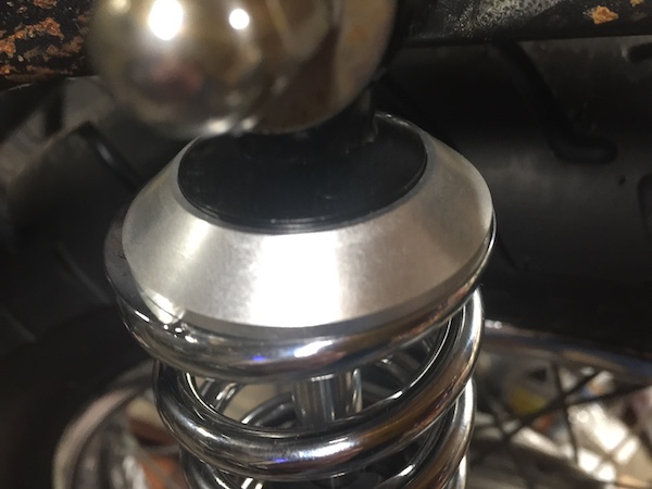

New shocks to complement.

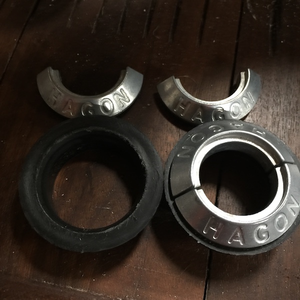

I was a little disappointed to see the new Hagons come w these ill-fitting, cheap looking collets.
I sent an email to Hagon.  A few days later...They sent me the a set of the old style collets w new bushings.

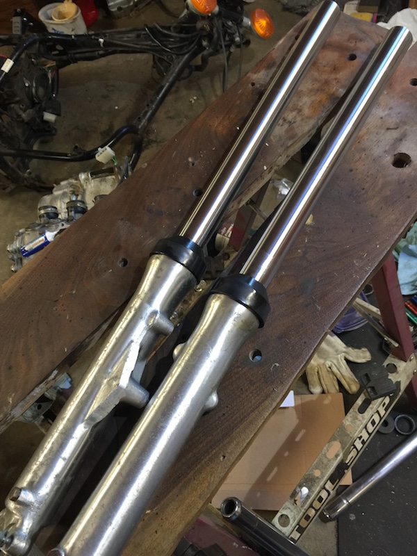

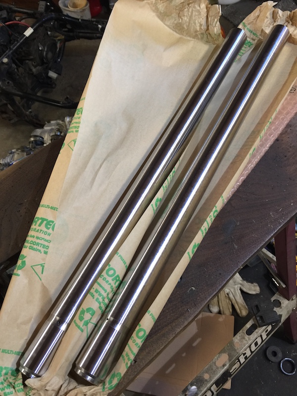

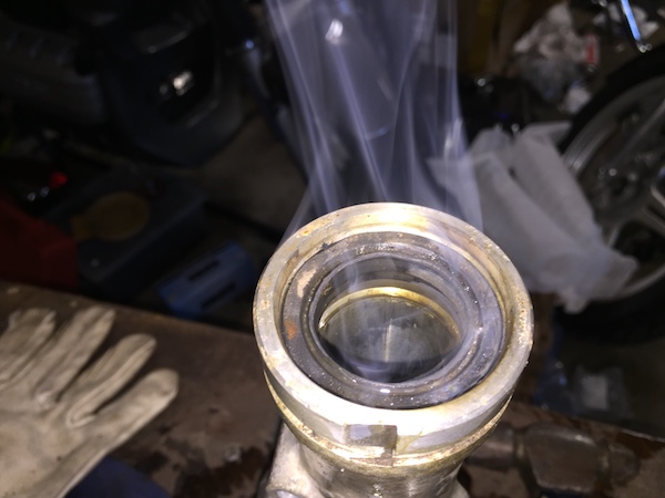

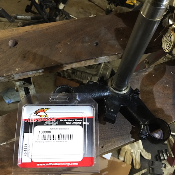

Out w old fork seals in w new seals and pipes.
Tapered bearings kit installed.

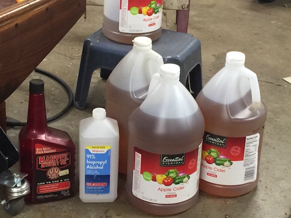

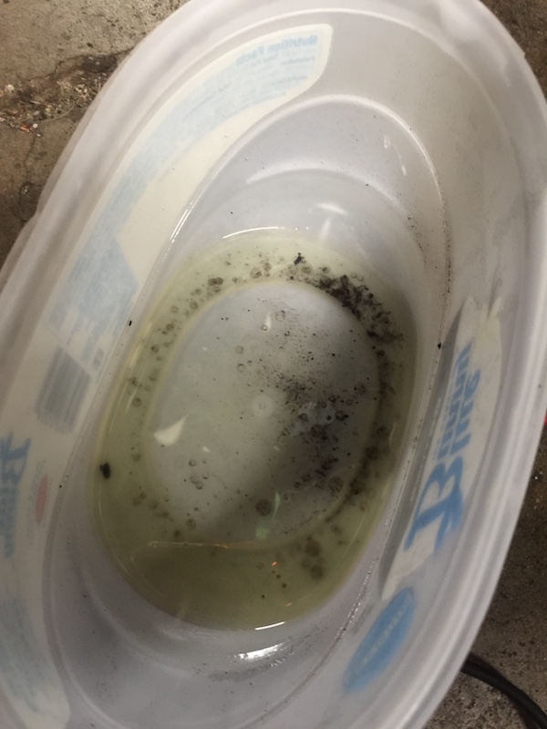

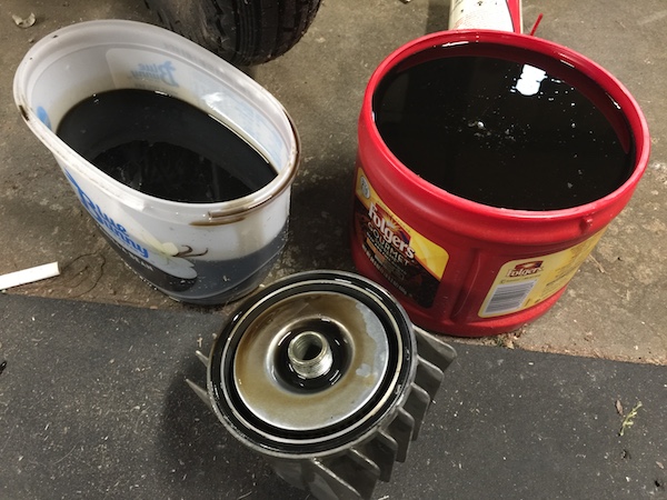

3 days soaking tank w apple cider vinegar, water rinse, alcohol rinse then Marvel Mystery to prevent flash rust.
Worked a treat on the rust.
