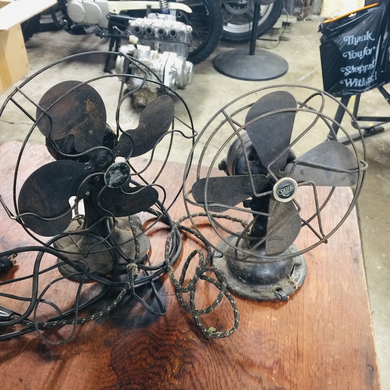

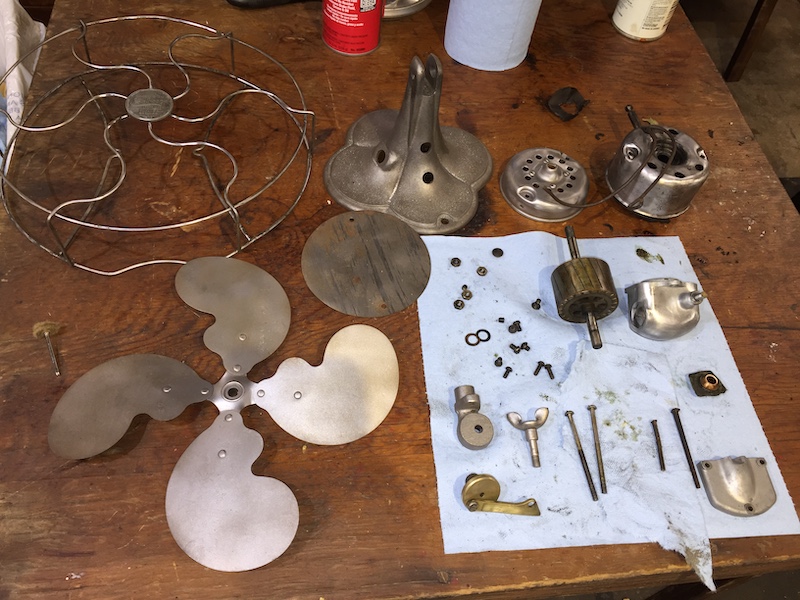

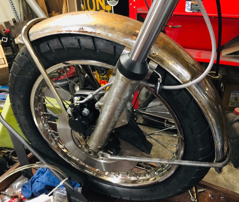

Working to get a few Christmas gifts ready.
Managing to get a bit done whilst waiting for new cordage and switches and stuff.
Fresh brake buttoned up and fender fitted.

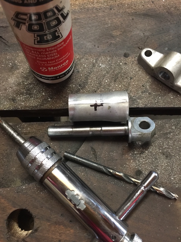

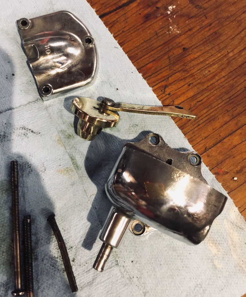

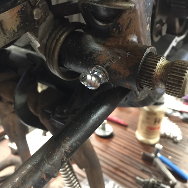

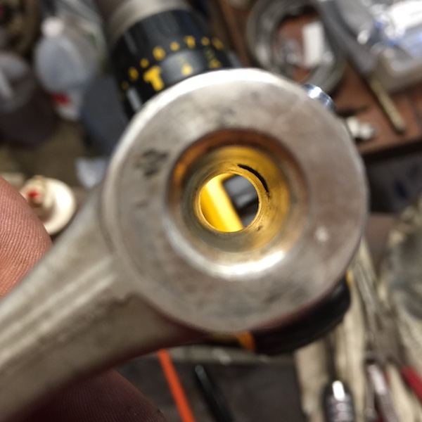

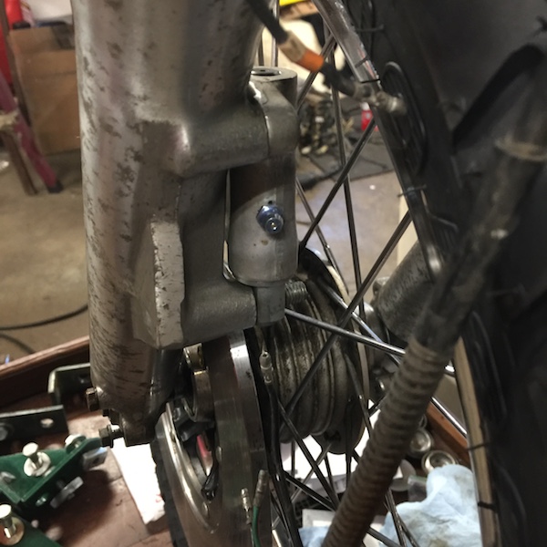

The pivot was seized hard.
Boiling penetrant w heat gun.  It finally freed.
I decided to make a quick change for ease of servicing ...
While the tools are out...why not do the rear pivot too?

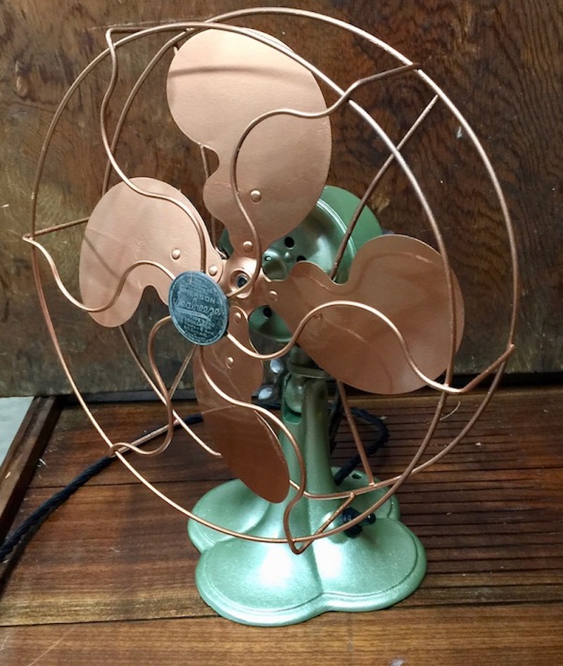

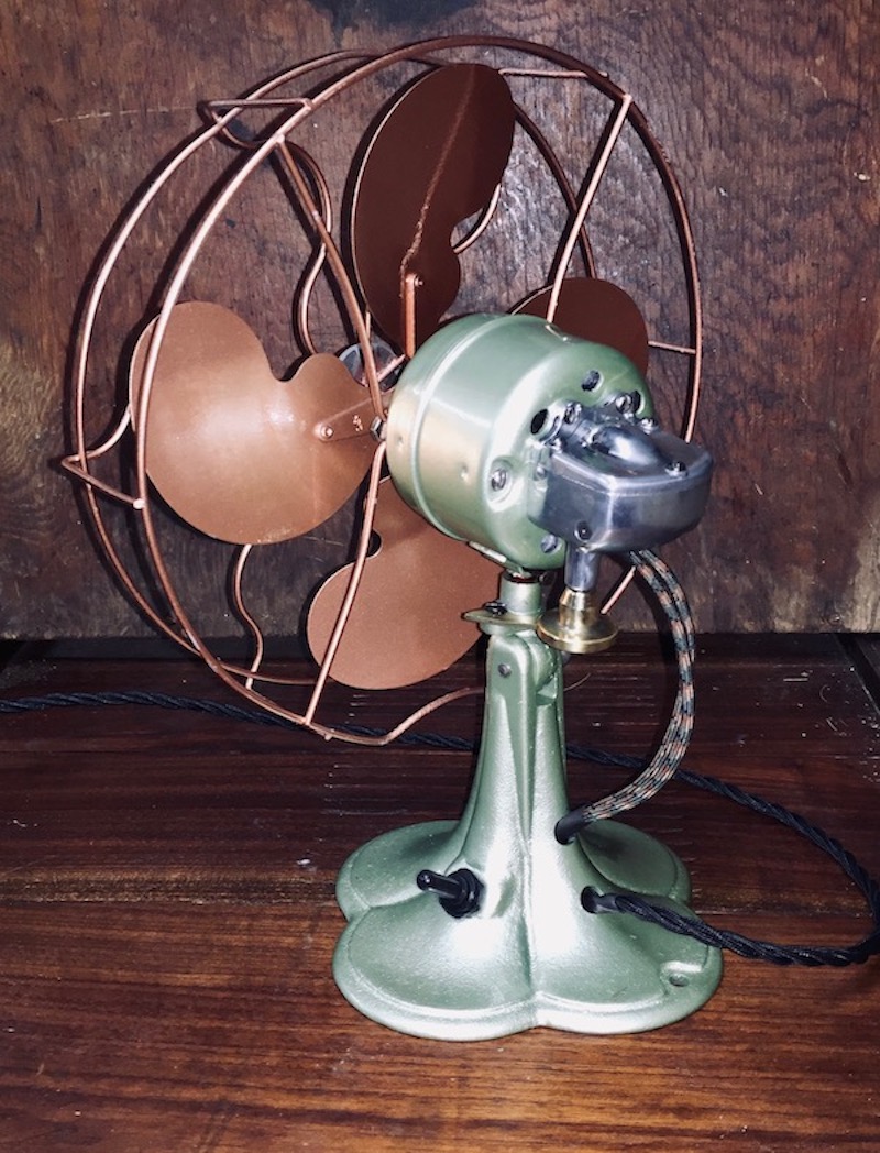

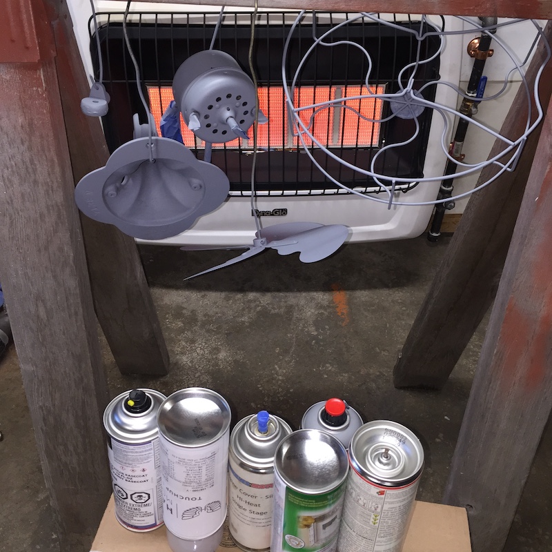

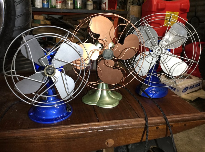

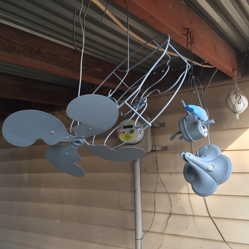

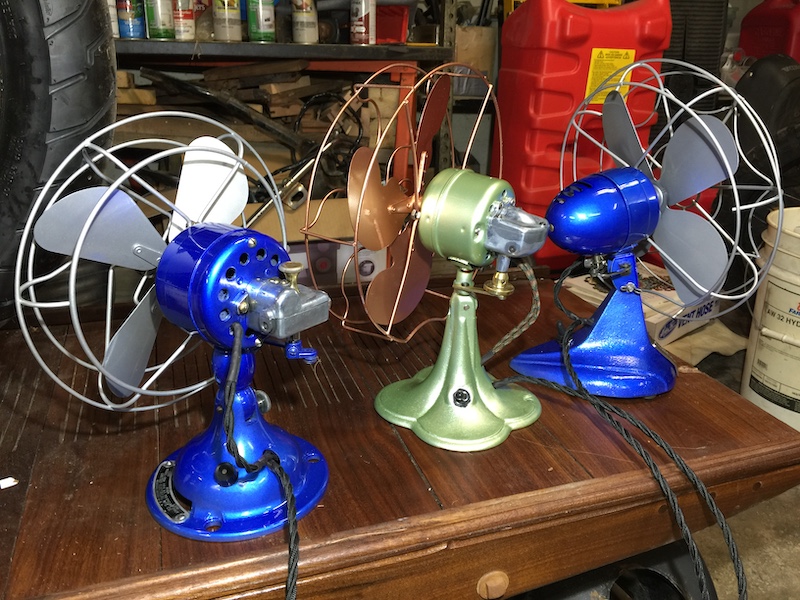

Heres the first one finished, for Rachels Christmas to go in our bathroom.

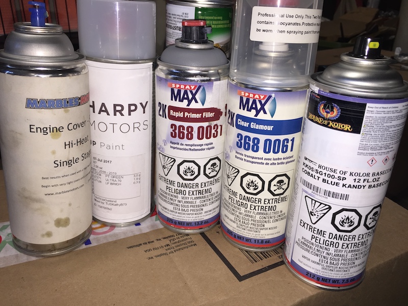

Thought Id give the 2k primer a go.  It goes on and sands just like primer.
Rach really likes the new Subaru color, Jasmine green, so that came from Harpy's motors.
My 2nd fan, going in the garage, will be House of Kolor, Candy Blue.
And all finished w 2k clear.
https://youtu.be/sh5cXv0uS0A
Re: The Black Knight...Side job
« Reply #64 on: December 20, 2018, 08:01:06 PM »
Nice job with the fan, you can't beat home made Christmas presents.

Thanks so much bud.
