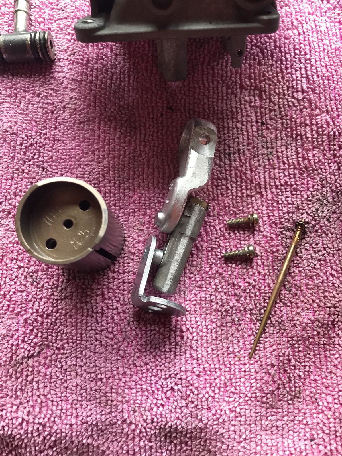

Also these are the carb needle securing screws, one of which is damaged. Is there a reason for this little spot on the top? They all have one so I can't imagine its a coincidence?
IMG_8120 by Mark Woodrow, on Flickr
Its to tell you are jis not phillips or pozi.
Good luck with the insulator clips, them must NOT  be any wider or it will cause air leaks
