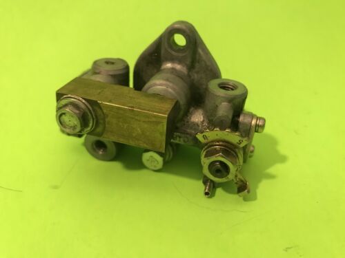

Here is the chain oiler pump, a little gem of a thing, its made by Mikuni. There is a control at the right where you can turn it up and down, depending on how much mess you want to make. Oil comes in via a banjo attached to the threaded boss on top, and leaves via a rotating shaft at the rear, which plugs into the end of the gearbox output shaft. Used ones are £150 a pop on Ebay, plus P&P from the US.
