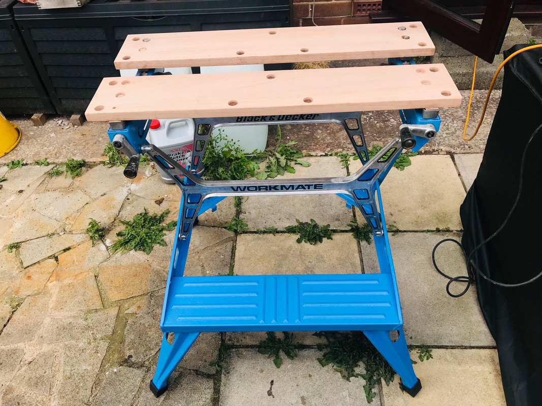

Finished it Roo. Bolts came today.
It's not to my satisfaction if I'm honest. I intend to replace the front board and modify the new one so it gives me more working area. It will do for the time being though. Not varnished it yet, might as well wait until I do the new board. I also need to do the bolts on the rear board.
Re: 550 F2 started!
« Reply #391 on: August 23, 2022, 08:34:02 PM »
That’s quite something Ken. I have one the same and they are very handy. Got mine from an elderly neighbour who’s husband passed away in the mid eighties. It has been used a lot.

"It's not to my satisfaction if I'm honest. I intend to replace the front board and modify the new one so it gives me more working area. It will do for the time being though. Not varnished it yet, might as well wait until I do the new board. I also need to do the bolts on the rear board"
You miserable git ;D ;D
That looks the absolute swingers Ken,give over!
Now stop arsing about and crack on with those weeds in that path! ;) 8)
Top draw as ever mate, better than when new. 'Work Mate Monthly' are gonna flip when they see that! ;) :D
