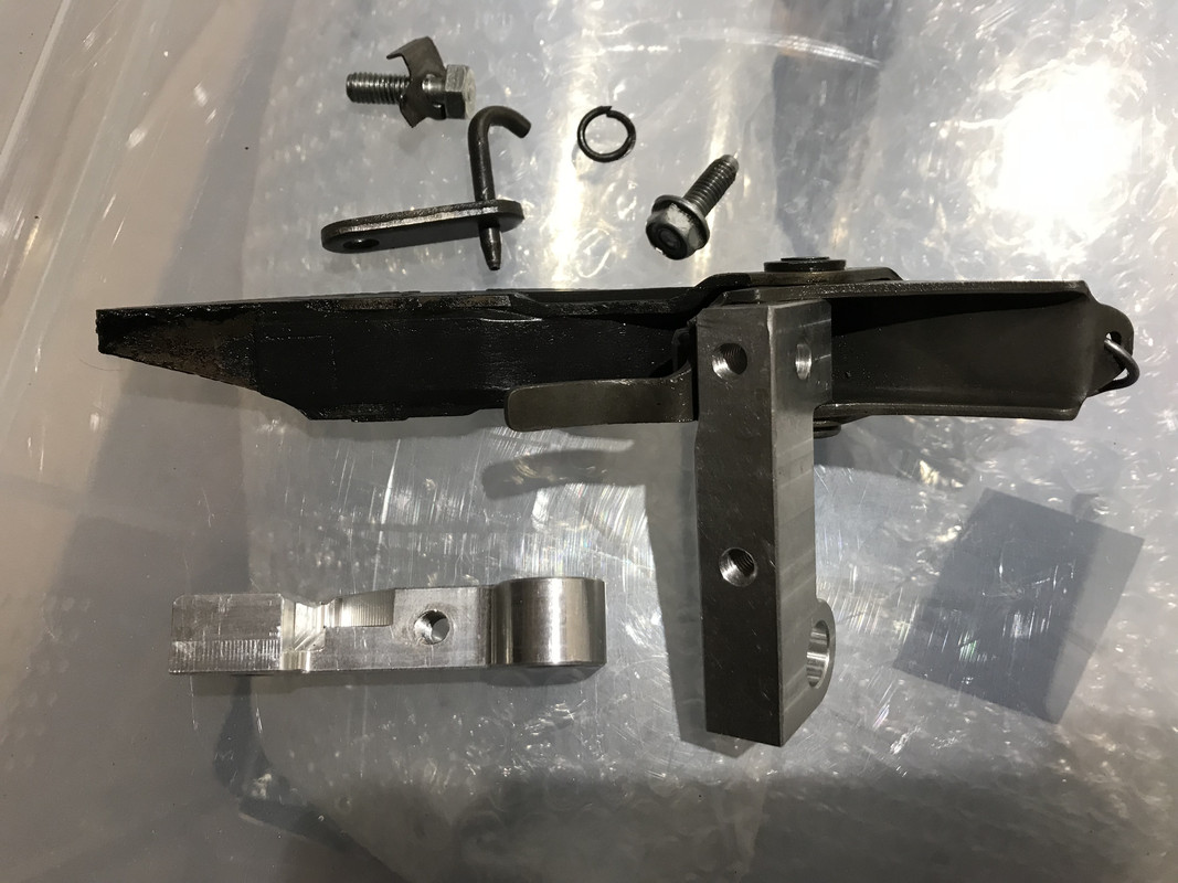

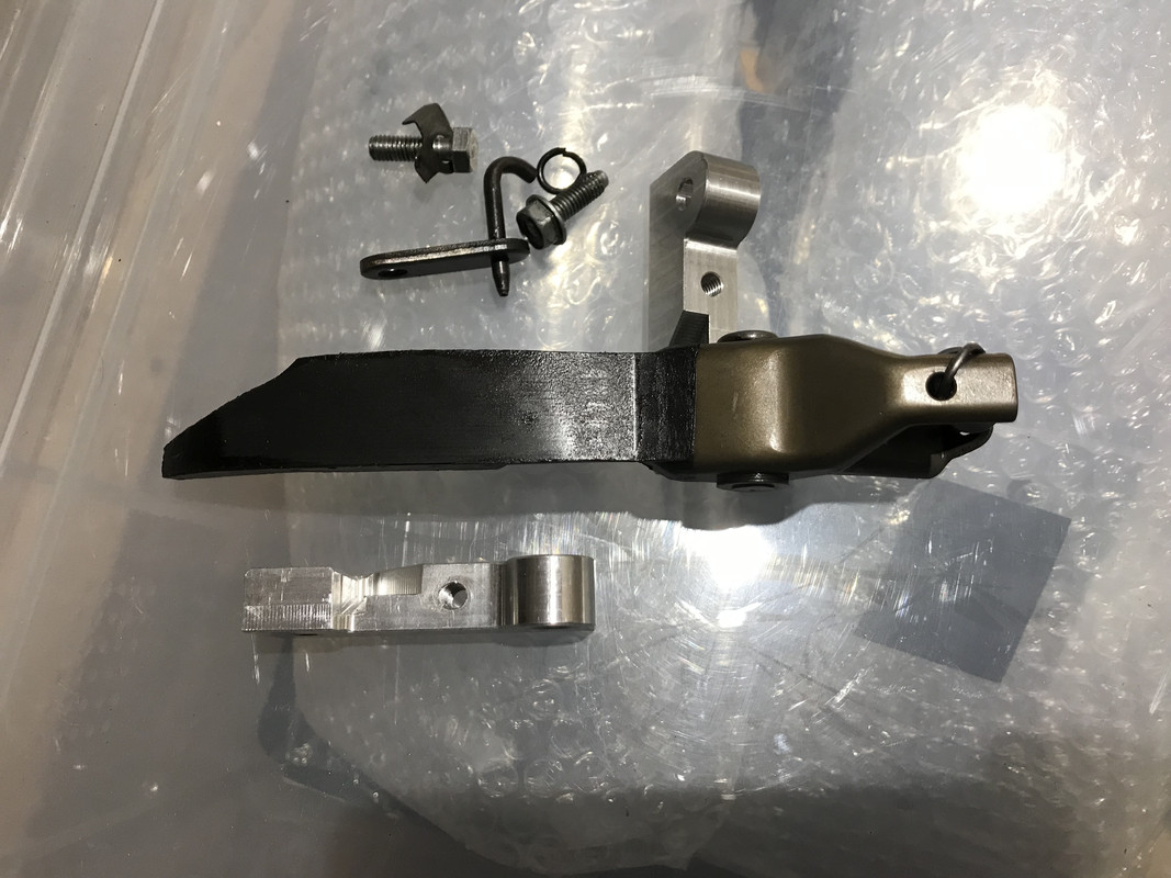

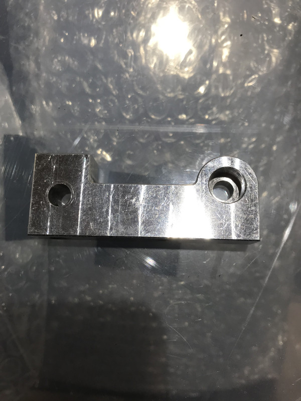

Ok here Phil.
I've included the 650 primary chain tensioner in the last 2 pics so you can see what to look for. One bracket is attached to it.

Thanks Ken and Murdock

la parte dificil es conseguir el tensor
the hard part is getting the tensioner
Re: 500K2 engine rebuild. Newbie questions
« Reply #19 on: February 11, 2022, 09:43:40 AM »
Indeed it is. I couldn’t readily find a tensioner so decided against the mod.

Cheers for the drawings and info guys. This really is a very helpful forum!
I’ll try and find a 650 tensioner before I make the bracket. I reckon once everything is replaced in the primary drive it will be good for years to come as I won’t be doing lots of mileage. The one thing that I’m picking up from reading the posts on the forum is regular oil change, and using good quality oil.
