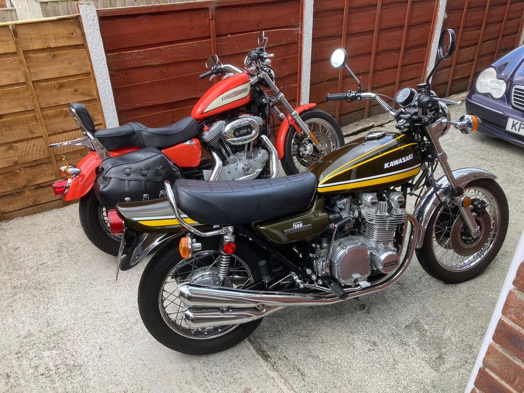

The Zed and the HD outside together last week.
the Zed is fine but sometimes there's a dribble from the carb overflow that soon stops (I need to recheck the float levels, one may a a bit high), plus a leak from where the Pingel tap goes into the tank, more PTFE tape needed?
We're off to the Hebrides on the HD next weekend - I only keep it as our 'holiday' bike, but the bike has other ideas. Having got an MOT a couple of weeks ago, we went for a test ride on Sunday, only to find a fork oil seal had failed - the right side of the bike was covered in fork oil, it was smoking where it had gone on the pipes and my leather jeans now have one leg more waterproof than the other! Luckily it didn't get on the brakes. I'm afraid I ain't going on the Z1A, I don't want to mess it up from its brand new condition plus I worry if I can't see it, it's worth thousands in bits. This may bring me to sell it, no point in keeping it if I'm going to be so precious about it. :(
New seals ordered and in the post, it should be sorted by Friday as long as I'm not let down, glad it went now and not once I got to Scotland! I'll keep you posted.
