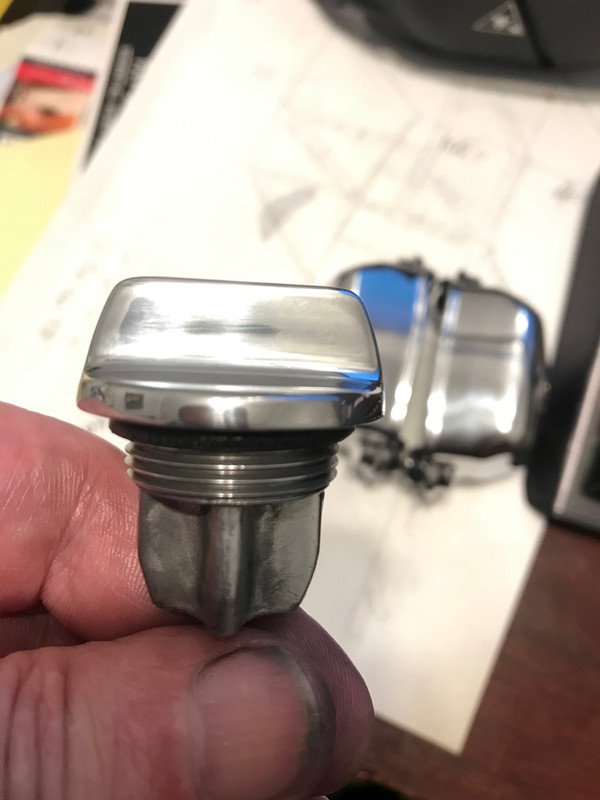

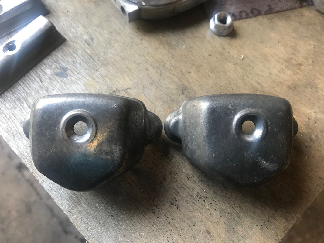

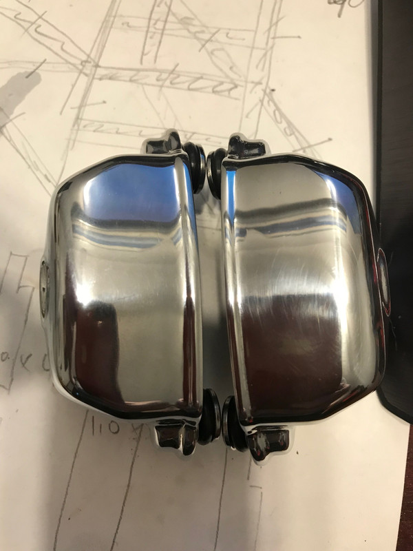

Camcover end caps are finally done Simon, came out reasonably well. I also did a surprise for you as I remembered you needed it.
Here's some pics,
Before. As you can see the condition wasn't great, no big dents or cracks but the surface is heavily contaminated with oil and grime. There were some surface scratches and small stone strikes that needed removing.
After, not perfect but acceptable I'd say. I've replaced the O-Rings with some brand new Viton ones I'd bought for my own caps, I bought 20 so I had some extras lying around.
And the surprise, didn't replace the O-ring on this as I haven't bought those yet.
Hope you like them, I'll bung them in the post tomorrow if I get the chance. Should still have your address somewhere.

Wow - what can I say !!! they look fantastic and night and day from the original
And the dipstick as well !! you were right the old one did let the side down somewhat  :)
You Ken are a true gent but I'll pm you as your really need payment for all the time and effort you have gone to
Many Many thanks
Simon
