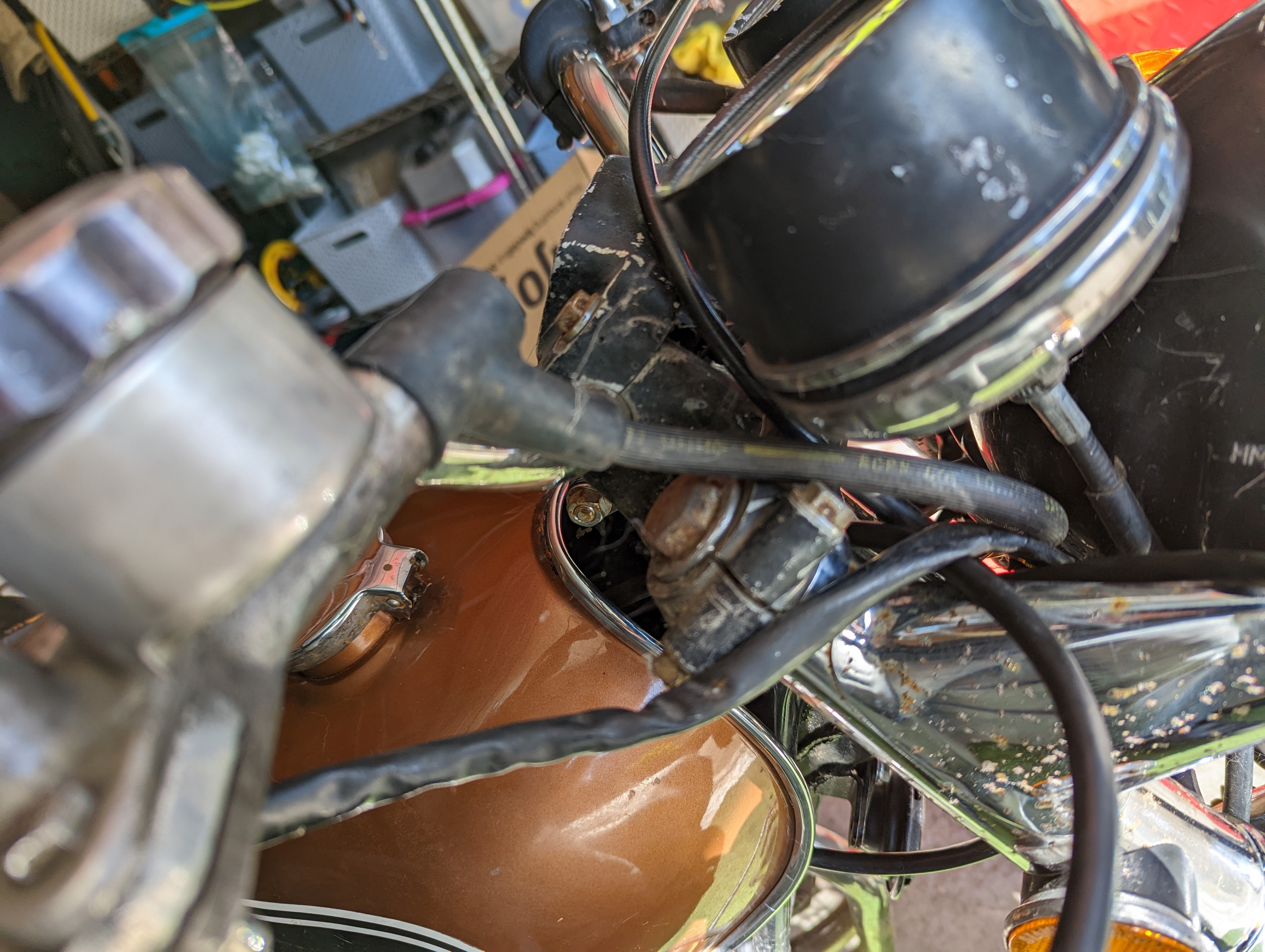

CB500 upper front brake hose routing
« on: September 17, 2022, 09:09:04 AM »
Morning
I've looked on the PDI instructions but still am confused on the routing for the upper brake hose ..... also if I've got the longer hose fitted for higher bars ? as the original isn't available
Any pointers appreciated
Thanks
Simon

« Reply #1 on: September 17, 2022, 09:17:14 AM »
Hi Simon,
Do you know the length of your hose - it certainly looks long - might be the angle but is the hose touching/rubbing  the chrome fork ear?

Hi Simon,
It's hard to get an exact measure but from fitting to fitting approximately 35cm
It does touch the chrome ear
Simon

Hi Simon,
Simon
I see what you mean about measuring - mine is about 25 cm - my pipe sits in the middle of the gap between the headlamp & the fork ear.
PS My clutch cable route seem odd it pass through the right side of the headlamp/fork ear gap under the left side of the petrol tank crossing over to the left side throught a frame gap next to the coils.
.500 pipe route by Macabe Thiele, on Flickr
front bars view by Macabe Thiele, on Flickr

« Reply #4 on: September 17, 2022, 11:27:54 AM »
Mine definately seems longer than your hose ...... your throttle cables seem long ?
My clutch cable goes as pic - under RHS of tank (as sat on it) then under the frame and down in between the carb manifold

« Reply #5 on: September 17, 2022, 11:54:33 AM »
Sounds like my clutch cable route is positioned as it should be.. The throttle cables are pattern ones already on the bike. The guide clip under the tank is absent so they do not loop down enough I suspect.

« Reply #6 on: September 17, 2022, 01:11:23 PM »
The switch wiring on a 500 is supposed to run through the bars and be none visible Ted. Have the bars got the slots on the underside to accommodate this?
Nah no slots - not sure what bars Bryan fitted it with tbh.

« Reply #9 on: September 17, 2022, 03:44:55 PM »
That hose is way too long, i think i have enough of the stainless hose left to make one up for you, price depends on length
Bryan
I'll have to try and find a difinitive length - does your stainless have a cover over it to look OE ?
Also the PDI doc seems to suggest the route is through the oblong hole behind the clocks ? or is it routed correctly and just over length - if the latter I may be able to get a measurement near enough using Ted's findings
Simon

« Reply #11 on: September 17, 2022, 08:37:43 PM »
It's supposed to go between the clocks and in the hole in the clocks bracket.

Don't rely on my measurement Simon as I used a steel rule.
Somewhere the correct length for the correct bars will be known.
My bars are I think from a 550.
I thought so - thanks

« Reply #14 on: September 17, 2022, 09:42:47 PM »
Might be the change of route will loose some of the excess hose - worth a try just cost a  bit of brake fluid.
