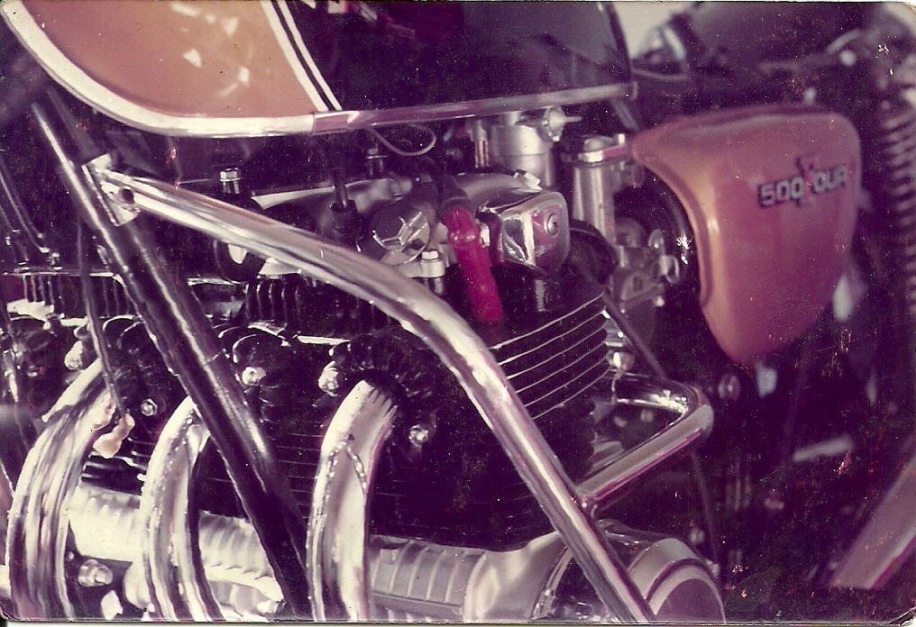

I'd also advise turning the coils backwards so the leads come out of the rear, then route the leads over the top of the engine, there should be clips on the end breather cover bolts to hold them in place. The coils perform better backward, less chance of water getting forced into them by the wind so less chance of them arcing out.
You can see how I did it many moons ago.
Looks far tidier without the leads dangling across the front of the engine and no chance of a lead touching an exhaust and getting burnt through.

No, they fit fine afaik. It could be that you need to swap 1-4 to the other side but essentially if the leads reach from the left they’ll reach from the right, it may be that number 1 lead now goes to number 4 but due to the wasted spark system it doesn’t matter. The numerals just slide off the leads if it bothers you that they read wrong.
Straight HT caps on the inner cylinders and right angled on the outer cylinders. As per picture.
