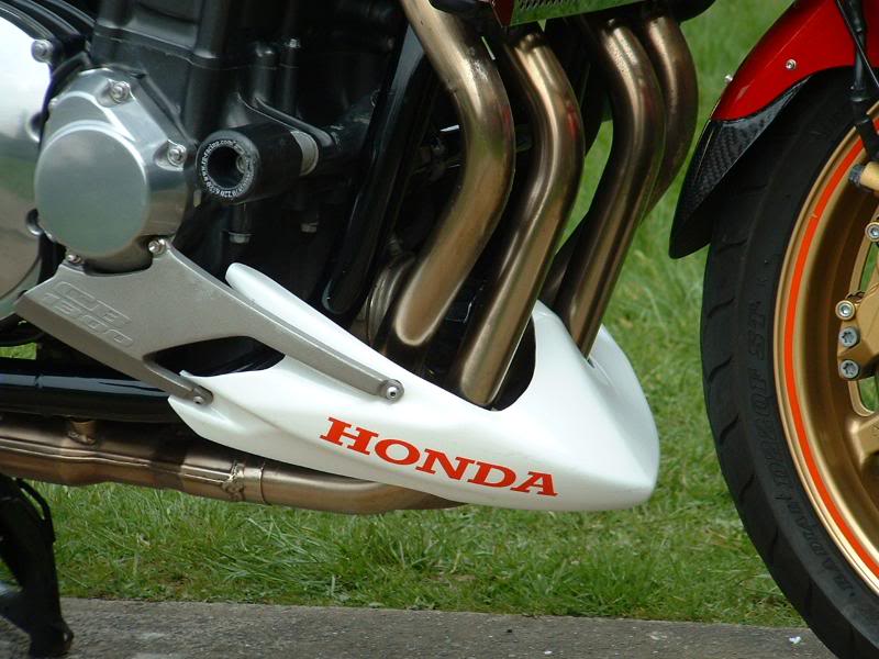

I didn't say they were using it on all models Graham, I just said they were still using it. My CB1300 for instance has the same finish on the clutch cover.
Does the finish on those look familiar?
Or do the grab rails and engine covers on this VT1100 look the same?
